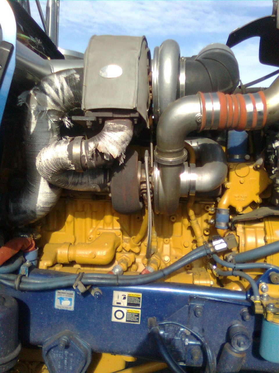

    At Antrim Diesel. Few years ago. Engine was in a Peterbilt 379 if I remember correctly, for normal highway trucking.
    Don't have further details, sorry.

    If that is the same truck, it runs very good with those holset turbo's stacked like that.

    I had a short talk with to the owner/driver. He was very happy with it.
    3 years ago now, but I still remember his words:
    "I don't drive fast, but when somebody challenges me, I'm in. And I always win"
    and:
    "everything is balanced. When the engine is idling I can put a dime on it, on it's side, and it won't fall over"

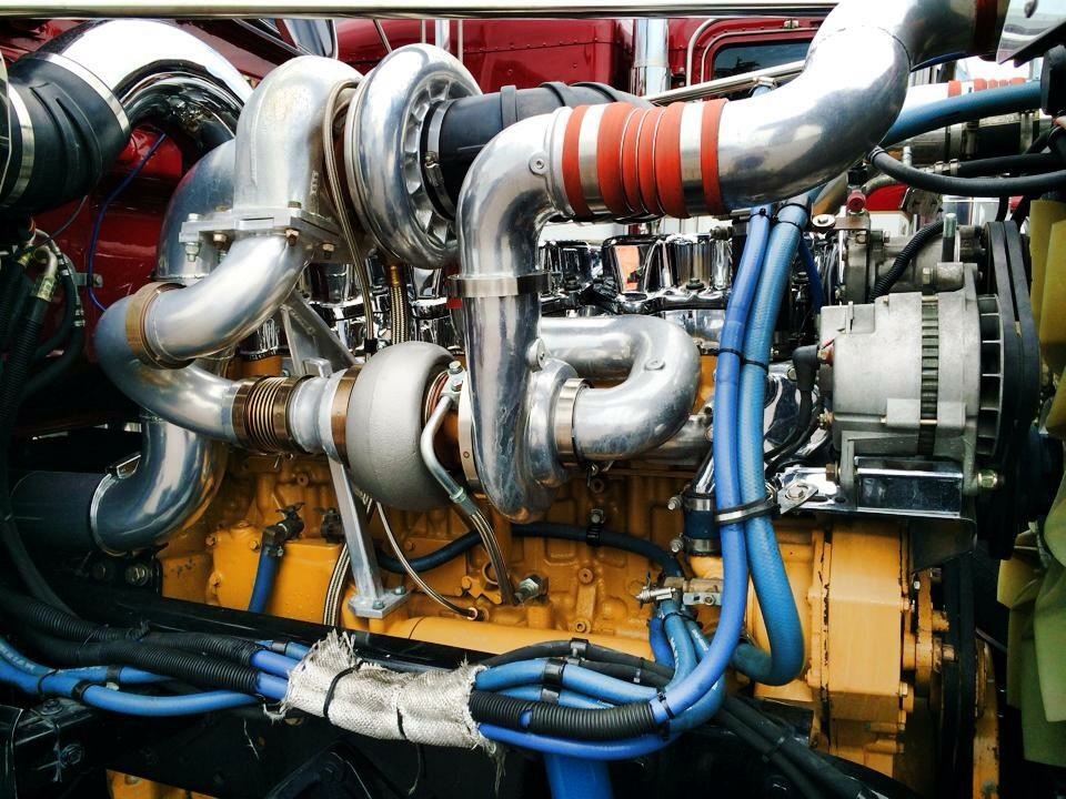

    I believe the picture KVB posted is one of the earlier designs Antrim used. Within the last couple of years they started adding a flex pipe between the turbos to keep the stress from different temperature changes and slight movements from breaking things. They suggest a non waste gate housing for the low pressure turbo, but I know Mr Haney still suggests a waste gate and says there's less of a drop in HP on a dyno with a properly set waste gate versus the non waste gate.
    The main benefit I see of running a compound setup with high horsepower motors is the low pressure turbo spools at lower rpm eliminating the turbo lag of a single big turbo and cuts down on a lot of the smoke from unburnt fuel. With the current movement of low emissions "clean" motors, less smoke equals less unwanted attention. I was told one well known gentleman that ran a 900+ hp 5EK that he was able to run from the East Coast to California and never had any problems with this setup. If he was gentle on the accelerator pedal all that would come out was a light haze. If he stepped on it, it would still smoke like a train.
    Here's a picture of Antrim's more recent setup found on the internet. Cat Compound Turbo Antrim Diesel.jpg

    That is a work of art right there.
