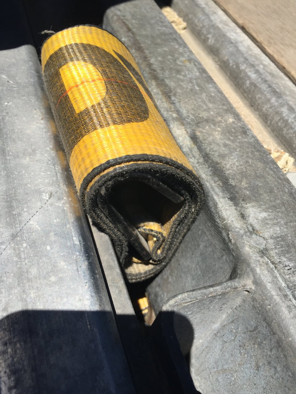

    So what's the best way to store straps. I used to store them in my box but dealing with the rubber gaskets and all I figure storing them on the winch is best but I don't see a good way to secure them. I could put the hook up through the gasket and hook it to my j track but then I have to worry about forklift drivers hitting them. I'm debating if I should just start pulling them off. 20160610_080154.jpg
    Also wondering about washing the tarp. The paperwork says no acids or harsh chemicals just soap and water. I'm wondering if I should stop using blue beacons brightner on my trailer so none of it gets on the tarps (not sure what the brightner is and what it could do to them). I'm also thinking I don't want them using the high pressure hose on it. Will that matter? And do they still charge as a flat or as a van?

    I used to have them do soap water and brush on the sides. Always came out legit.
    Straps: I used to hang the hook in the j track on the edge. When loading or unloading I'd drop the hook into the channel between the seals and just let it set down out of the way. Then hang it back up before closing up and leaving.
    Hope that helps
    Chewy352 and MJ1657 Thank this.

    Yep that helps. The way I've got them now just doesn't seem secure to me.

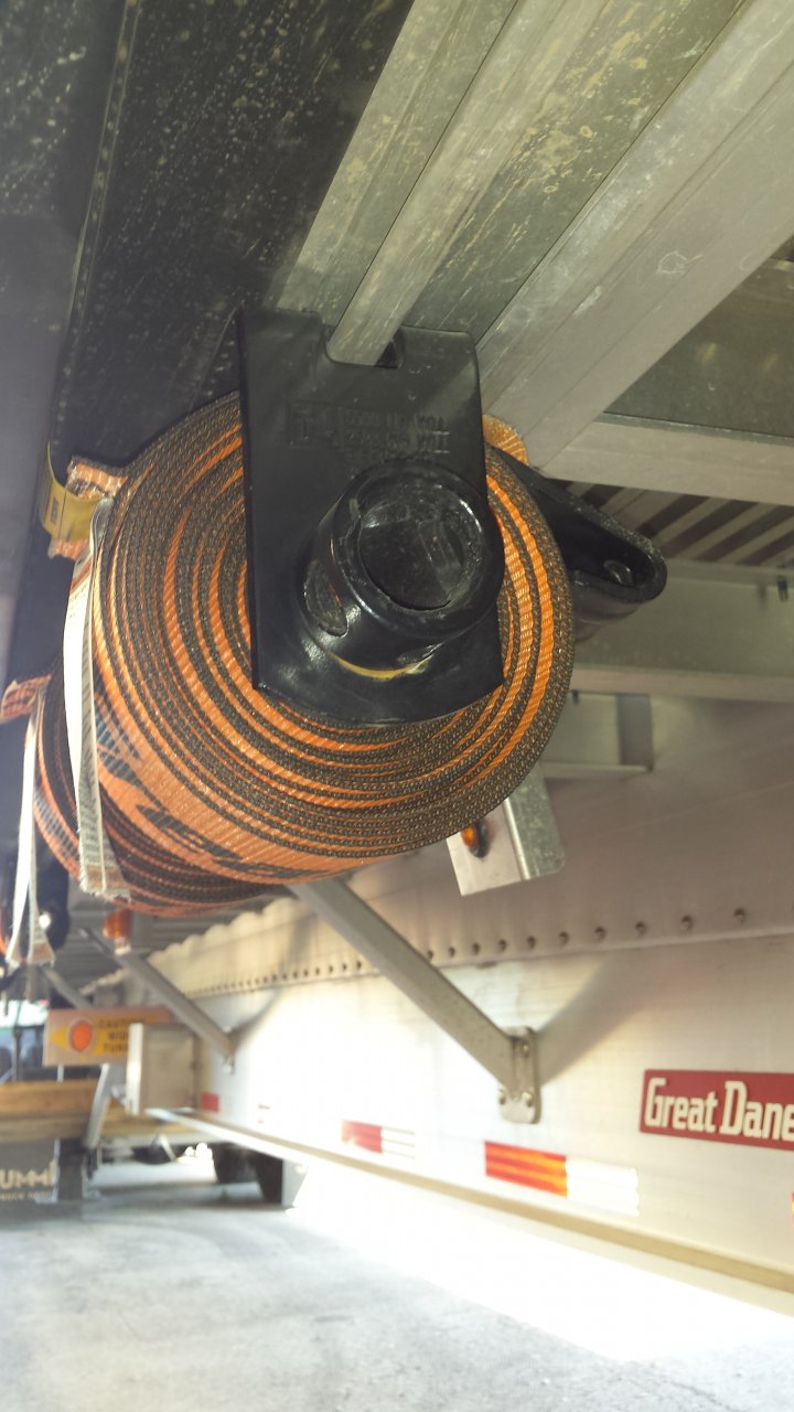

    Chewy I put a few wraps of the strap around the hook (so it becomes too big to drop out of the void) and then snug the winch down so they don't unravel going down the road image.jpeg

    Why not take the straps off the winches? To much of a PITA?
    I'd really like to have one, but I think it would end up being more of a curse, not to mention I really don't need the added weight.

    I prefer to remove mine from winches on open deck. Running them up thru that gasket can be a project if you're doing say 20 thru. If the straps were off it wouldn't be as bad. Stuff the hook down thru on the hook side nice n easy, sling the strap up n over n push the strap end down thru....depending on how flexible/stiff the loose end of strap is, and depending on how tough that strap side gasket wants to be...could be a project. Still prolly easier that way. Dismounted would keep rolled on the winch/unused straps out of the weather as well.
