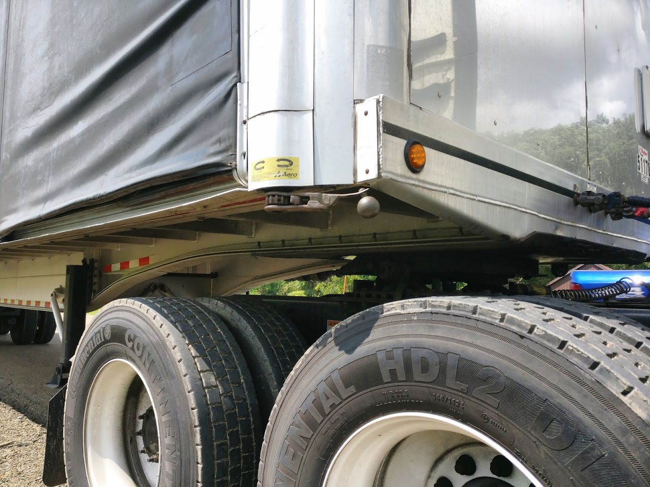

    Here's a photo of where the marker light should be but is missing.

    So it has 2 marker lights on the side and this clearance light on the bulkhead?

    Yes. It has one marker light at the rear and one marker light in the middle of the trailer...and this clearance light on the front of the bulkhead. It does have weld marks underneath the frame at the front-side of the trailer where the original front marker lights were attached.
