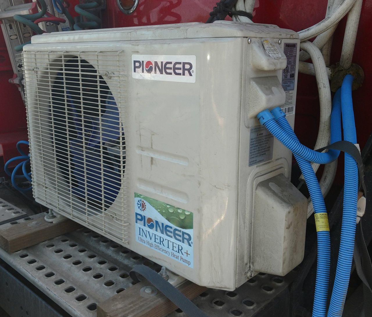

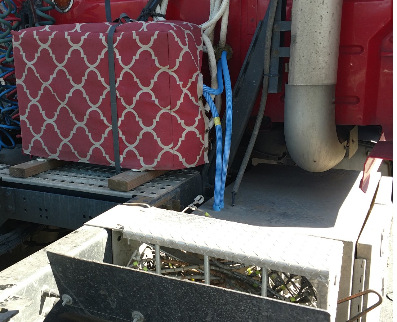

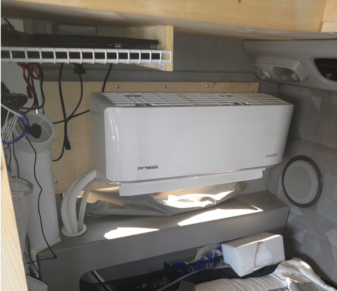

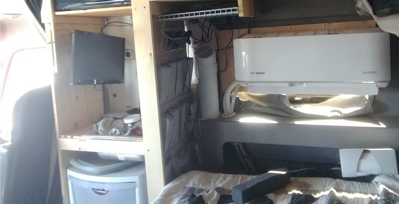

    IMG_20180420_163005965.jpg IMG_20180420_163526397.jpg IMG_20180420_163150560.jpg IMG_20180420_163058285.jpg
    These are some pictures of the split system on our 780. I wish we'd removed the top bunk earlier and placed the inside unit on the wall there. It's entirely too cold sitting in the booth with that running.

    So I'm curious, how long have you had that installed and how does it hold up to the road salt/abuse over that time?
    I like the idea, I'm just leery of longevity (more than 3 years) since those are designed to be installed on an immobile (nearly) corrosion free environment, whereas my truck runs a lot of northern climates in winter... (And as such, I'd prefer to have a water cooled generator rather than air, not to mention diesel instead of gas)

    It's been on for a year and still runs great. We keep a canvas cover on it while driving, and I haven't noticed any corrosion or anything getting inside. We were in the shop almost the entire winter, so I can't tell you if road salts affect it.

    What's the total cost of installing it? What size unit and what brand and size generator you are using? Have you mounted the generator on side of truck?
