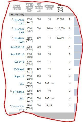

    One thing to consider before converting a 9 to a 13....
    What are the loads demands your rig will be tugging?
    A 13 manufactured as a 13 was designed for different conditions than a 9.
    A converted 9-13 is in reality a "Little 13".
    You also may want to factor in your engine Horsepower and torque; and you might also consider your rear-end ratio as well to see if it will make sense to covert.

    Ron, will have to respectfully disagree back back, and profess my ignorance, as I am not seeing what you apparently are.
    Looking at what you posted, I don't see that a 9 turned into a 13 is weaker, especially when really, all you are doing is adding a splitter section on the back of the tranny.
    If you have a convertible 9, rated at 1600, and a "regular" 9, rated at 1600, and a 13, rated at 1600, what is the difference?
    I honestly do know what kind of 9 my buddy had, but it was converted by a mutual friend of ours that has a tranny, and diff. rebuild shop, and the truck owner is one that will put equipment to the test, believe me.
