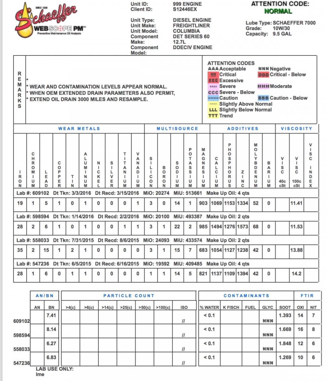

    Still trying to find the additive package of LOS. From everything I have seen from what others have sent it to the labs, LOS is nothing more than a 150w base oil... no additives of any kind.
    Either way, here is a group of 4 samples from my factory remanned S60 with over 500,000 miles on it. The first two (most recent) are from using a 10w30 syn blend and the second two from 15w40 syn blend. The 10w30 is working quite nicely. The latest sample shows the lowest wear numbers. The 10w30 is holding viscosity and TBN much better than the 15w40. Just the oil, no goofy stuff added.

    Well, the OEM lube manual for mine shows using 10w30 approved for the same range as the 40w oils. And I am not really sure what the ambient temp has to do with anything when engine is at operating temp in a water cooled system. 1000F at the turbo is still 1000F irregardless of winter or summer. And engine oil is cooled by the cooling system and never gets above engine coolant operating temperature. I suppose if we were talking about air cooled motors, it might be something to consider. Now does Cat backpedal or just some tech in a shop?
    Well, you did say that you had to do bearings a year after trying 10w30, so I find it pretty doubtful that the 10w30 caused the problem without some serious evidence of such. Like oil samples from before and after using 10w30 showing that wear metals from bearing escalating. Oil pressure does not totally correlate to proper lubrication. Heck when my engine is cold, I get 62 PSI on my S60 at startup, but no one would suggest it is getting the best oil protection at a cold startup as opposed to when it is warmed up. And oil pressure is a measure of resistance thru the motor, oil filter, etc. A few PSI lower pressure from a 10w30 as opposed to a 15w40 could be primarily because the oil is not meeting as much restriction getting into areas it needs to get in to not anything to do with whether the oil is protecting as it should.
