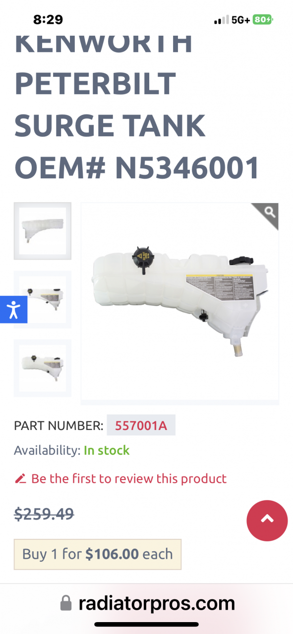

    Im having issues trying to locate a coolant reservoir for my truck. I use my engine serial number at Freightliner(which sells Detroit 60 series parts) and I didnt even try Kenworth yet. Im not sure if its a Detroit part or a Kenworth part.
    When I look online the only tank I see that looks anything like what im looking for is when I search Kenworth w900......
    BTW, ive got a glider and on my build sheet its one of the only few parts that isn't listed........ tempImage1drW5U.png tempImage26fSox.png

    There may be a # imprinted on the plastic. Not a Detroit part, so the builder may have to help you.
    But that looks very similiar to a Cascadia? resevoir. Maybe google pics can help

    Looks like a 2008-2018 W900 tank to me. Cooling package is chassis side not engine side.

    It’s definitely a KW part. VIN should work. If for some reason it doesn’t , being a glider. A similar model Trucks VIN should work. You just need the part #, hopefully find one online cheaper than Dealer. My guess is all the W9’s are the same. Detroit, Cat, Cummins. Really don’t know. Freightliner is that way.

    C0D8B979-866B-4AA7-B01B-89F6CA2F5E8E.png . Maybe maybe. Only 2 I could find. Nice price.

    get part number from kw and look online , I replaced mine while ago ...driving kenworth feels sometimes like rolls roys when I order from dealer
