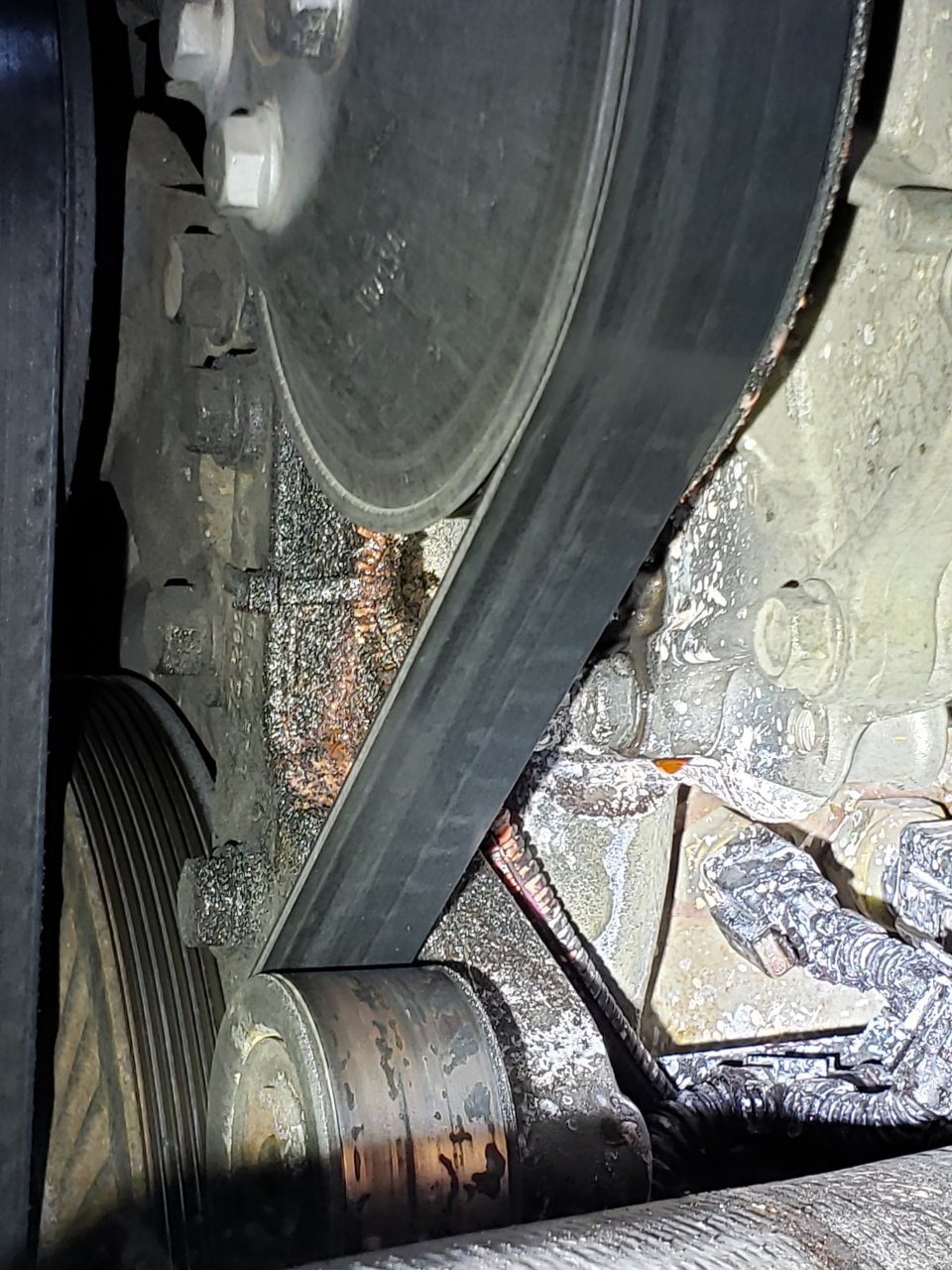

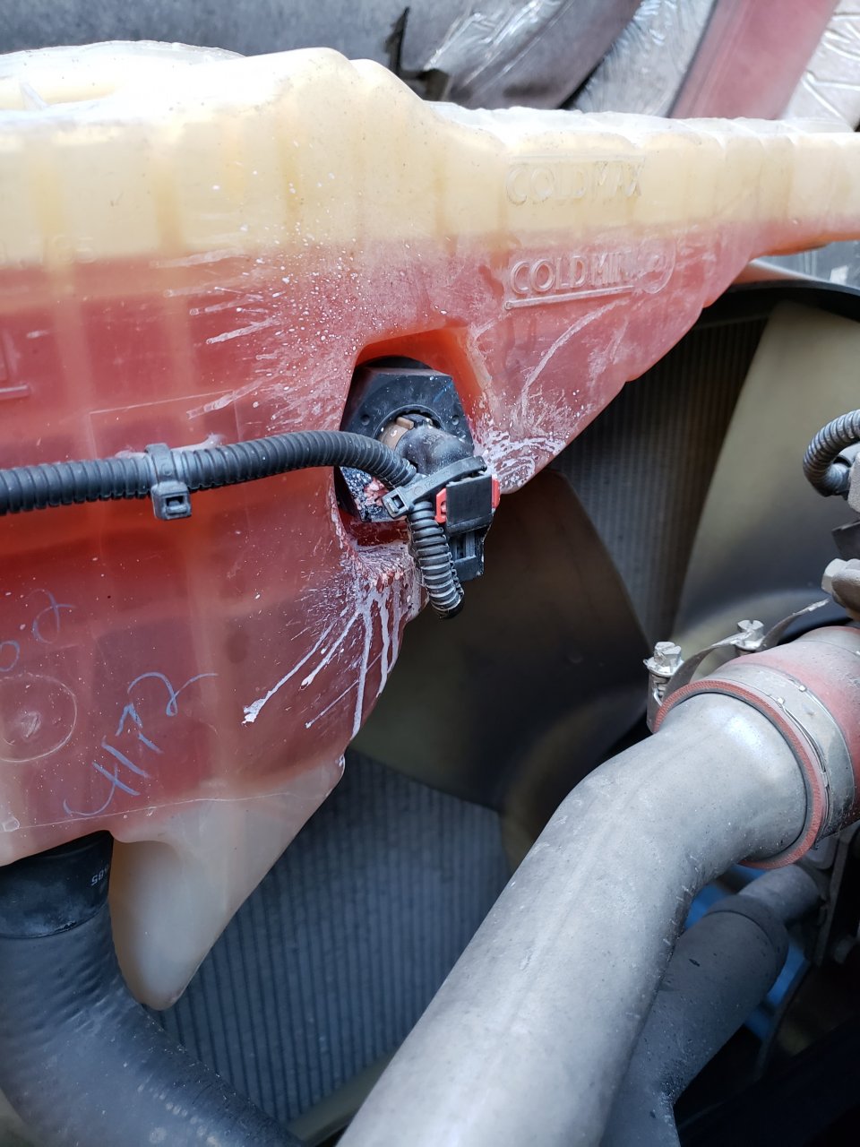

why is the coolant pump leaking from behind the pulley? That's the clutch right? also why is it leaking from the temp sensor? there's pink icing everywhere, I found the drip coming from behind the big round thingy
coolant thingy making a mess

No clutch on a water pump. If its leaking out the weep hole your pump is worn out.
Dino soar, Rideandrepair, daf105paccar and 6 others Thank this. -
I say water pump also, coolant reservoir not leaking enough to make those spots behind pulley and belt.
Rideandrepair Thanks this. -
Get Blue Beacon to wash it off.
Then watch to see where it comes back from.
The surge tank typically doesn't leak there. Possible though. That would be an o ring right there.
When they go, they crack.Rideandrepair and InTooDeep Thank this. -
Rideandrepair and QUALITYTRUCK Thank this.
First picture is most likely water pump failure. Look up under there, you’ll see a weep hole, if it’s coming out of that hole then the pump is failing.
Second picture, just try tightening the plastic nut.Rideandrepair Thanks this. -
weep hole it is, kind of it to give you warning ahead of time. 368k and it's only needed a starter, I ignored that warning for 6 months until I needed a tow. Everything is a wear item to eventually be replaced. driver included. what goes next after the water pump. I baby the gaskets by not moving it at all until oil temp is at least 150 F then gently up to 200 F, I keep the injectors clean with routine floggings and keep the cylinders clean with 24/7 engine brake. blackstone says it's the cleanest burning DD13 they've ever seen.
