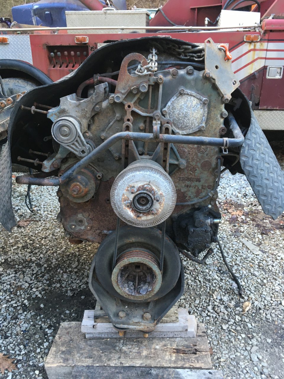

    How is the 02 MK edition it’s a 470 like my GK is, does it have piston coolers or is that for the better models I thought they went to 500hp with the ddec4
  3. Old dirty trucker
    Old dirty trucker Bobtail Member
    41
    47
    Oct 24, 2021
    I found out today that my 02 MK does have piston cooling nozzles but still not sure what the factory torque setting is. It’s 470@2100, hopefully can hook to ecm soon and see if it has a tune or not. Also not sure if it’s the iron or steel pistons

  4. Big Road Skateboard
    6,190
    34,010
    May 2, 2021
    Should have steel pistons, and 1650 torque

    It's cheap. Can you run it on a stand? Would that be even worth doing? Just throw it in????
  6. 77fib77
    77fib77 Road Train Member
    10,589
    66,498
    Jul 7, 2010
    St Louis
    Why not just rebuild the old one?

  7. Old dirty trucker
    41
    47
    Oct 24, 2021
    My front cover is in bad shape. It made it to 2 million with no rebuild, I’m going to rebuild it wile it’s on the ground and have a backup but a DDEC 3 to a 4 is a good upgrade and some companies need eld year compliance. Truck isn’t a 2000 or newer but engine is, or put my old valve cover on new engine (who changed a engine not me officer)

  9. Rideandrepair
    17,337
    56,256
    Aug 8, 2015
    When the 14L came out, it started at 500hp. 12.7 went back to being 470hp Max. It was sometime around 02-03 maybe that’s why the new engine is a 470. Just an idea. Either way, 470 always had better fuel economy. Must be the injectors. Don’t know. Not sure about the newer ones. Pistons are 16:1 on 99 BK and newer. Not sure when, but they had 17:1 pistons later. Maybe Marine only. Don’t know for sure. Just some things to consider. If blocked drilled, rebuild kits come with new nozzles. You can rebuild with a BK kit. Pk pistons cause the white smoke, till warm. Probably from the LO NOX reprogramming that supposed to be done at overhaul. Might want to find a drilled block, pre 2000, to build the original. They also have drilled rods available. Be nice to build it your way, instead of most shops, that will only replace with original. Any of them are fine, as long as your not going racing. Higher HP tunes, need the best stuff. So I’ve heard. Haven’t had mine tuned yet. Kind of Leary about it all.

  10. MAMservices
    MAMservices Medium Load Member
    486
    3,386
    Aug 9, 2021
    Years back I inframed two engines that customer bought of which had been sitting several years. They were out of wrecks from a major fleet with low mileage on them and looked nice. After they installed them immediately got coolant in the pan. Dropped the pan and coolant was leaking past o-rings. Apparently o-rings dried or shrunk as they continued to leak until overhauled. I have been afraid of an engine that has sat up dry since then. Just something to be aware of.

  11. Old dirty trucker
    41
    47
    Oct 24, 2021
    The engine had coolant and oil in it still that looks good but who knows, I’m chancing it with no rebuild. How do these prices sound, engine removal and install $3700, engine rebuild $2650 plus kit price
