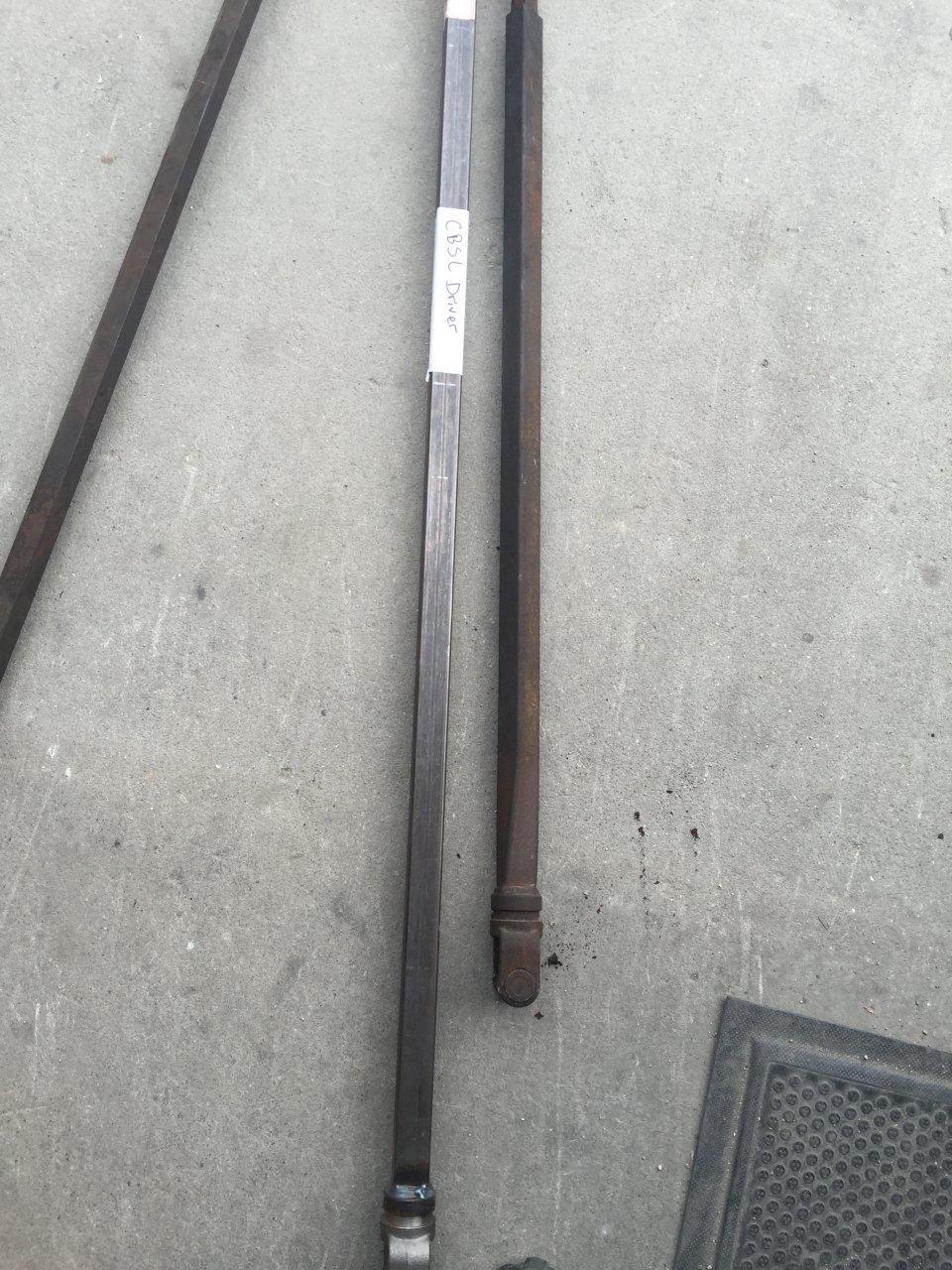

    image.jpeg image.jpeg Well, turns out I bent the pump drive shaft also, so I also had to replace that and the end bearings and repack the pump.
    Here's a picture of the twisted pto shaft.

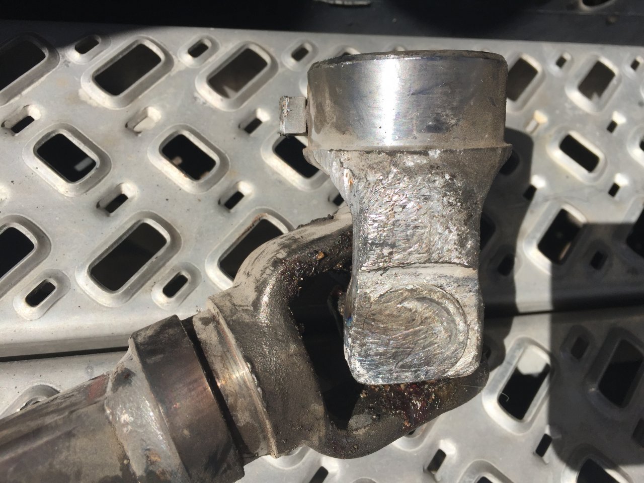

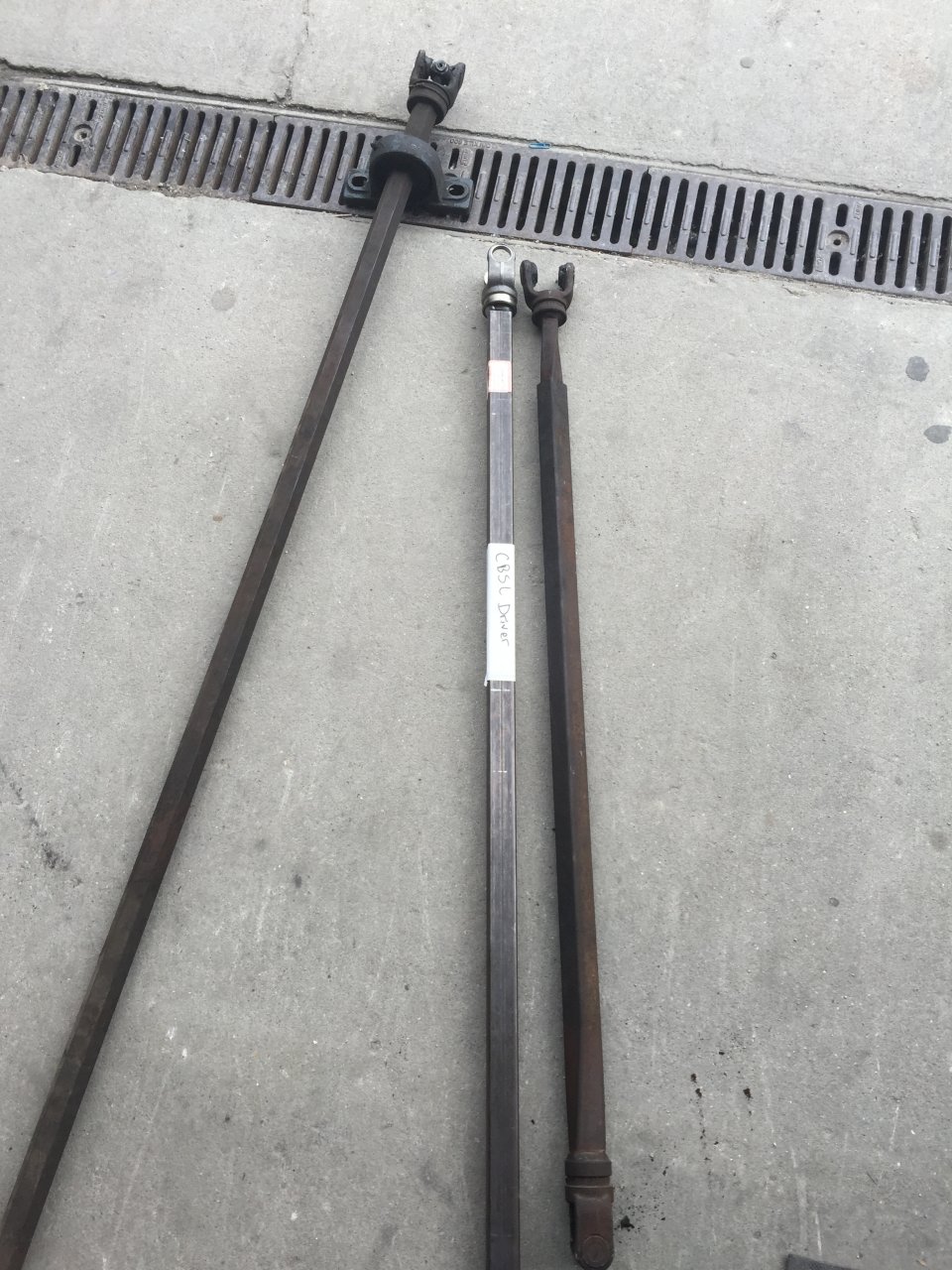

    Well, when it rains it pours........ Monday I spent hours rebuilding the pump and re hanging the pto shafts. For some reason, not yoke that connects to the pto shook off and got a little beat up by the road, but nothing too bad. The extension shaft then fell off a couple hours later while driving 65 mph down the highway. That one shredded the yoke, ujoint and service fitting. Lucky the shop I use had some and replaced them this morning. I'm really, really lucky it didn't rip apart the bottom of my truck.
