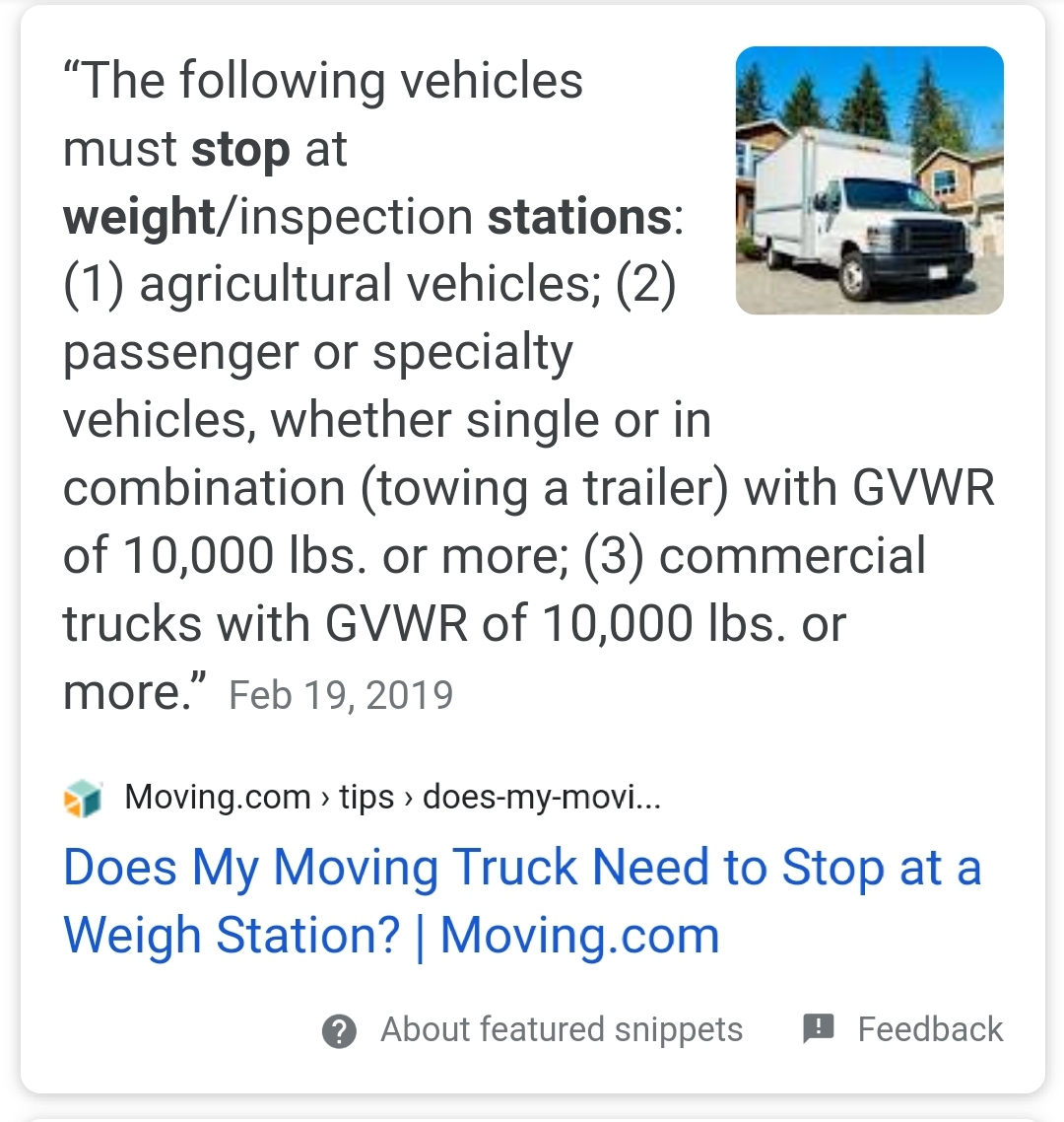

Vehicles from 10,000 lbs and up have to stop at weigh stations and have to be using an ELD.

So the term “vehicles” just means the power unit correct? So if my total rig, trailer and load is under 26k I’m clear of that, or no?

Clear of what? Weigh stations? ELD? No
Under 26k truck, trailer, load and GCVWR you just don't need a cdl in most stated.Mojo1960, Lite bug and singlescrewshaker Thank this. -
So I have to stop at weight stations and use an eld even if under 26k?Mojo1960 Thanks this.
as far as I know your over 10,000LB and your for hire so you have to stop at weight stations and your driving farther than 150 air miles from your base address so you will need a ELDMojo1960, Lite bug and singlescrewshaker Thank this.
