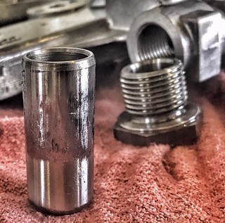

    I know of another CAT owner that had high oil pressure at idle - and the problem was a sticking Oil Pressure Relief Valve.
    [​IMG]Oil Pump Pressure Relief Valve - CAT
    Heavyd Thanks this.
