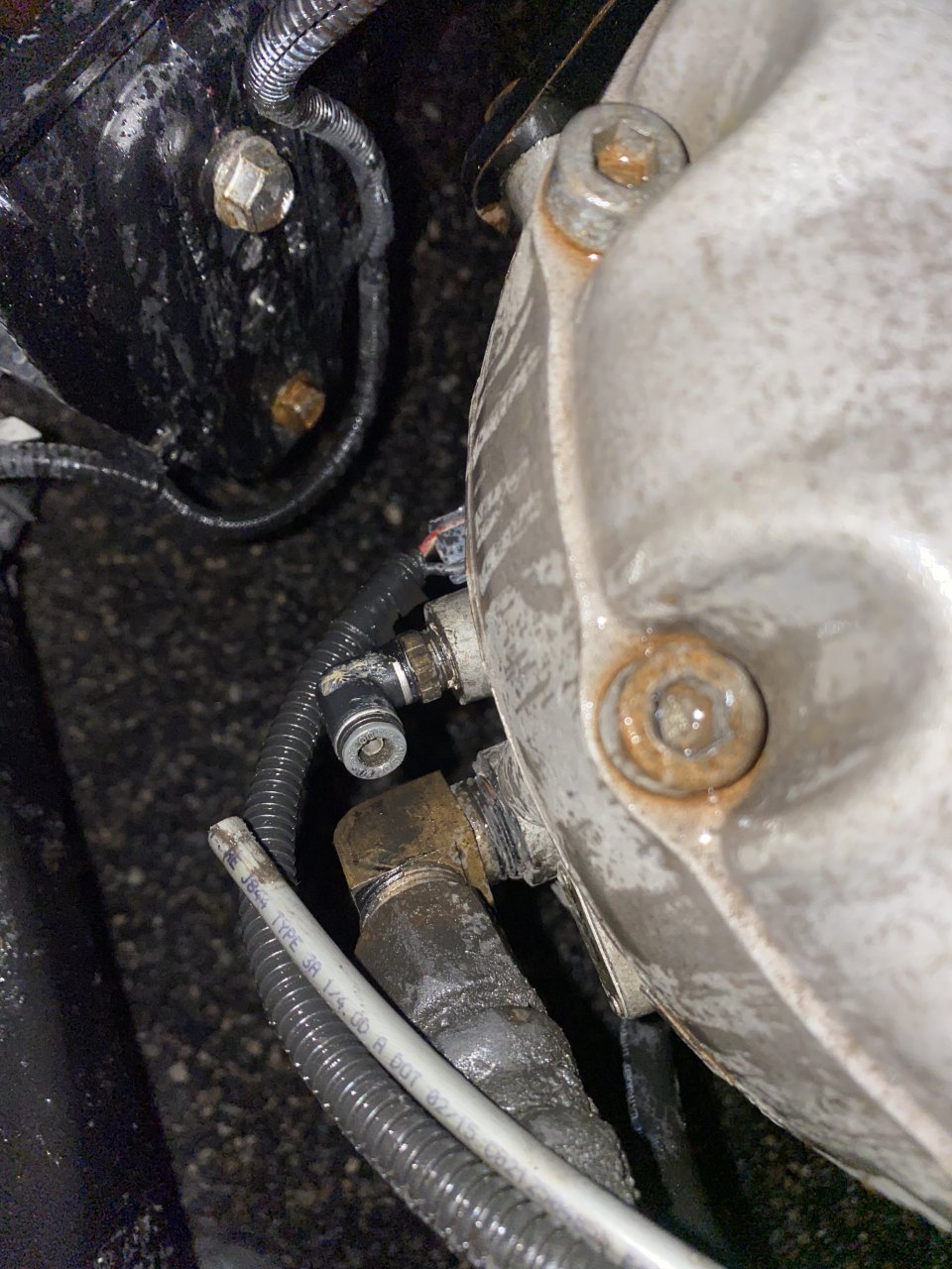

    How can yo
    u do that and not damage the compressor, plus it’s located in a very hard area to get to

    You can simply disconnect the braided steel Line. The compressor will just pump air into the atmosphere. Taking the load off of compressor head. If you want to be more thorough, you can crimp or loop coolant lines. Only run for a short time without coolant flowing through. 30 seconds should be plenty of time.

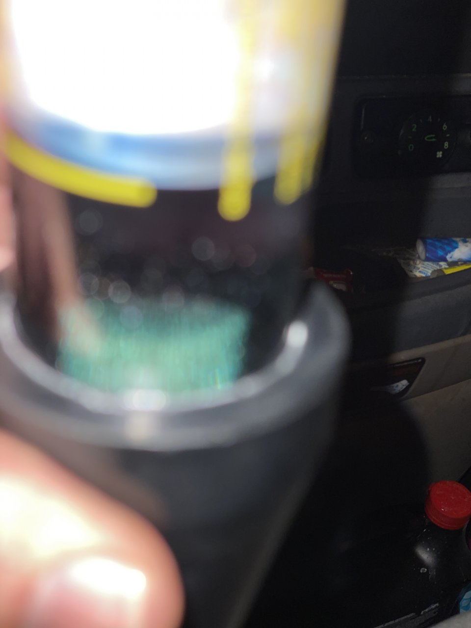

    Well ran combustion gas emission tester on coolant reservoir tonight did not change colors from blue - to me that’s hopeful it’s not a head , I’m really thinking this is the air compressor will try and isolate that tomorrow...... saga continues

    I’ve heard mixed results on those test kits. Mainly that they work well on gasoline engines. Not so great on Diesels. I’ve never used one myself. I’m not a Mechanic either. Just my Own experience with 12.7s.

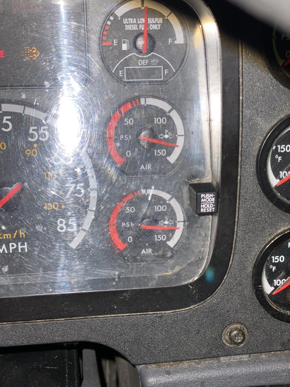

    I had a plastic air line small on air dryer took that off and didn’t see any change
    ps air psi gauges are up about 137 seems high.. used to be 110~~
    bubbles start in bottle just as soon as I start,, even after totally bleeding air...
    so much pressure from some #### where
    will see tomorrow

    See high gauges air 211ECBE0-37C5-4F35-B02A-8370085A95A2.jpeg 86B09214-CC2E-4D1F-A09B-5780D4534512.jpeg C0159C62-CA15-4070-8DF0-90723C802632.jpeg
