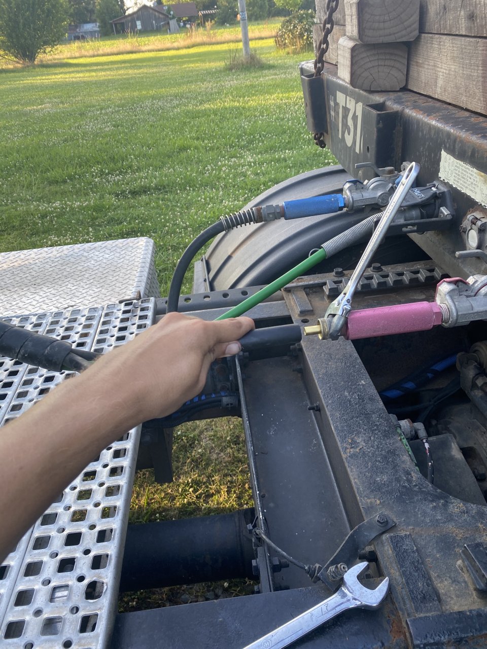

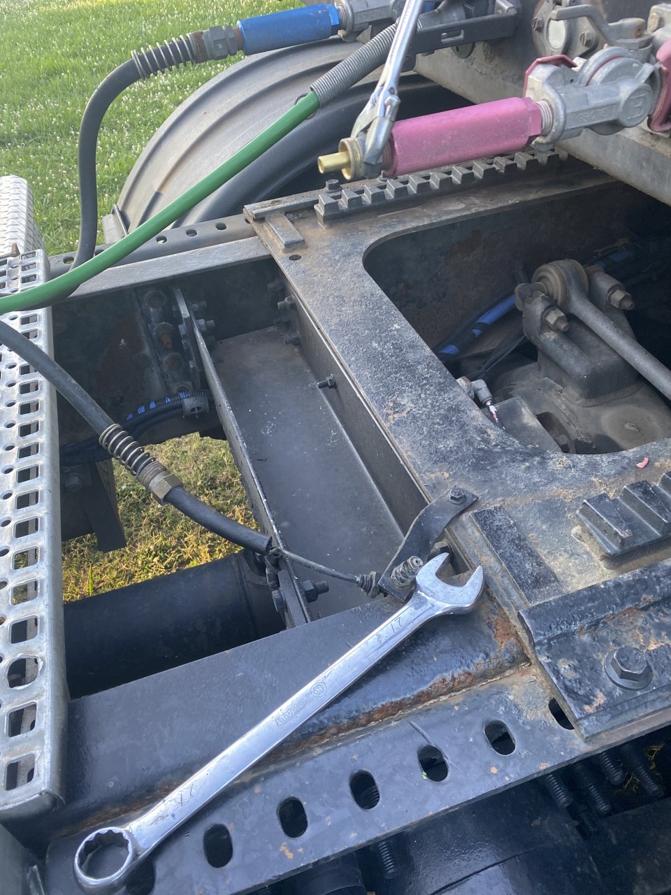

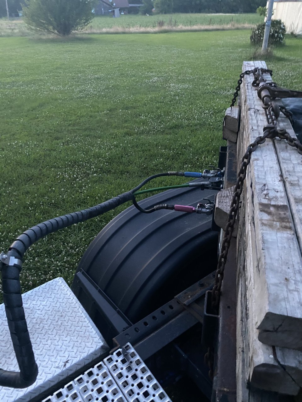

    Did the QUICK fix. Simple.appreciate it y’all. I didn’t even need the coupler piece. I cut it, and used a new brass compression fitting, I had enough slack to make it work without extra hose.
    DDA9F082-E094-4512-B958-E641EE1E8383.jpeg F6FAA012-588D-448D-BC91-A74A0BABF0DD.jpeg 099FC490-0983-48DA-9BCD-315F1C92EB44.jpeg

    Keep the coupler for an emergency.
