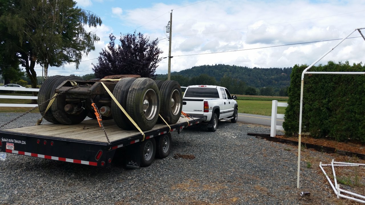

    States are allowed to have stricter regs on securement, I've driven wreckers, I've been around wrecker drivers. I don't blame states that have stricter regs on cars.
    If the feds wanted 4 tiedowns on cars it would look like this.
    (c) Securement of heavy vehicles, equipment or machinery with crawler tracks or wheels. (1) In addition to the requirements of paragraph (b) of this section, heavy equipment or machinery with crawler tracks or wheels must be restrained against movement in the lateral, forward, rearward, and vertical direction using a minimum of four tiedowns.
    Instead they say this.
    (b) Securement of automobiles, light trucks, and vans. (1) Automobiles, light trucks, and vans must be restrained at both the front and rear to prevent lateral, forward, rearward, and vertical movement using a minimum of two tiedowns.
    When you put them back to back it shows what they mean. If both regs mean the same thing (four tie downs) why write different numbers?

    So being that this post started all this, was it adequate? Bearing in mind I know next to 0 about securement regulations.
  10. johndeere4020
    8,522
    119,294
    Jan 1, 2010
    It was legal.
    MJ1657, 4mer trucker and AModelCat Thank this.
