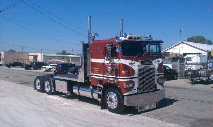

    Sure have.
    long-deck-1024x803-1217268000.jpg 1993-whitegmc-cabover133115285239-4-2978659792.jpg 9cf0cb9642adf5c701aefa01bcb78d79--van-classic-trucks-2782057847.jpg

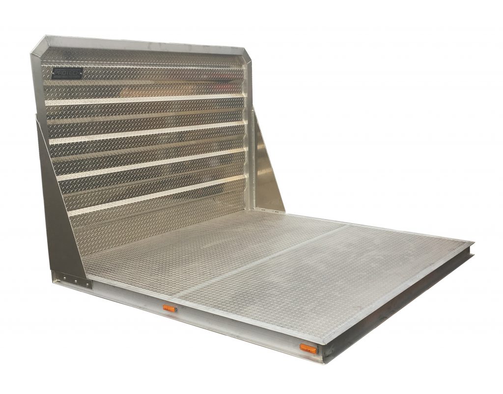

    I found them. Zoomed in on your picture. "Cab rack droms" is what protech calls them. Very cool thank you IH Truck Guy!
    IH Truck Guy Thanks this.

    Dromedary can get them as a flat or as a box
