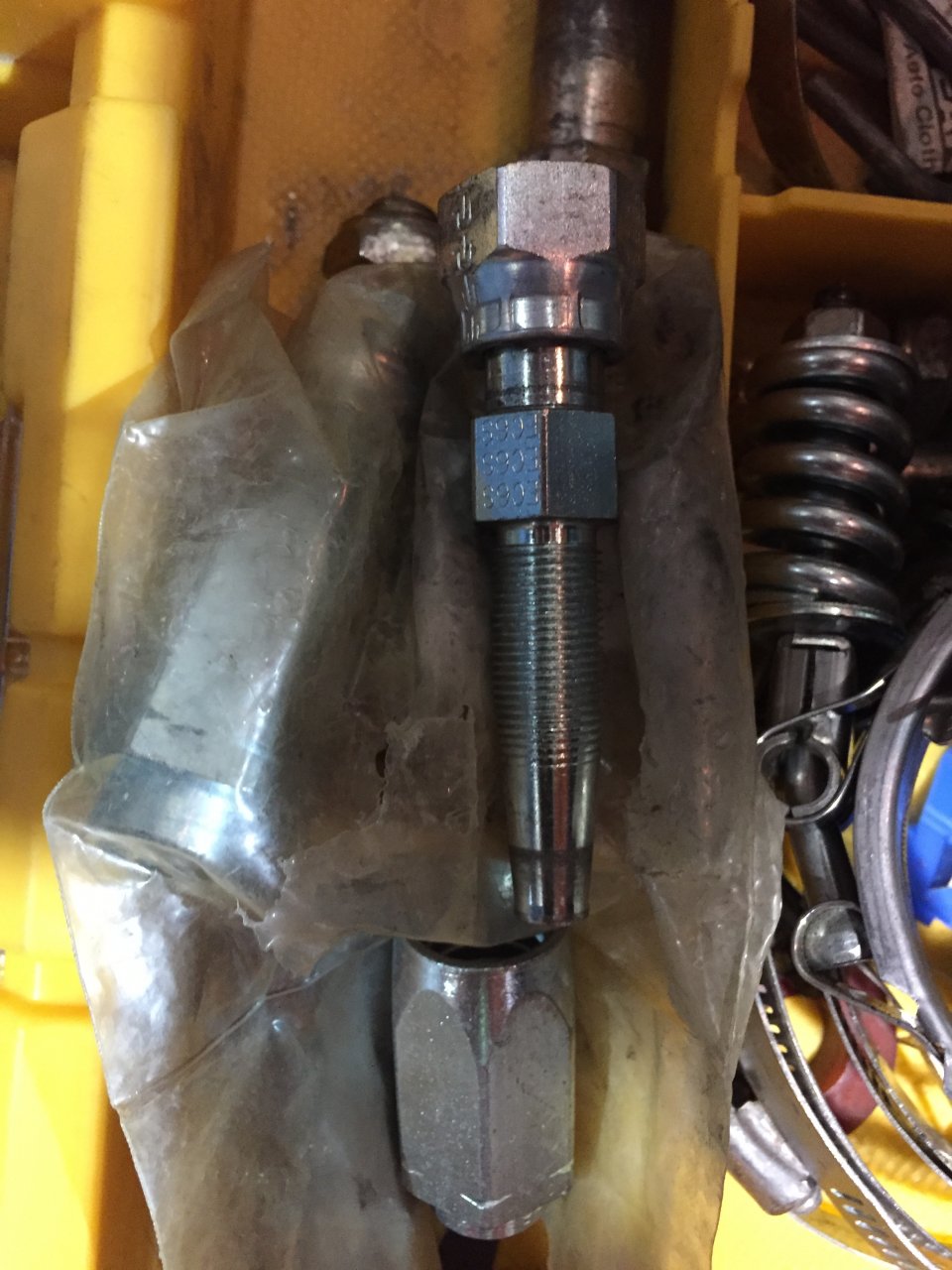

    044D0E26-E547-4590-BCC9-0FCBB0C2B27D.jpeg This is something like what Brian is talking about. It is designed for a blown line. Cut the bad part out and place the fittings on both ends and connect. This is a temporary fix in my opinion. The shop I use for most of my repairs has a press to permanently install fittings. It probably weighs 50 lbs or better.

    This style is called aeroquip fittings

    Yes, exactly what I was talking about. Thanks! They are perfect for quick repairs to keep you going, outside of that I have always used a good shop for my lines. Way too expensive to stock the pieces and the press to build them myself, even with a few trucks in the fleet at my hayday.

    Those kind are permanent also. Used on air line also. Takes some understanding and hard turning to get the larger ones in properly.

    The first fitting is left handed the inside fitting is right hand threaded the best lube for the inside fitting is gasoline believe it or not. Ripley
