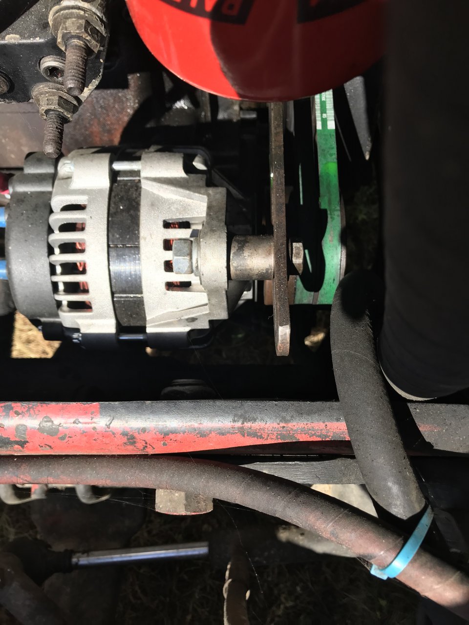

    Here’s a pic from the top. You can see how far back from the bracket it sits

    Standard J mount . Any J mount alternator will work. I dont see the confusion here .

    The 24si has brushes. The 26si is a brushless alternator. I personally like the brushless.
