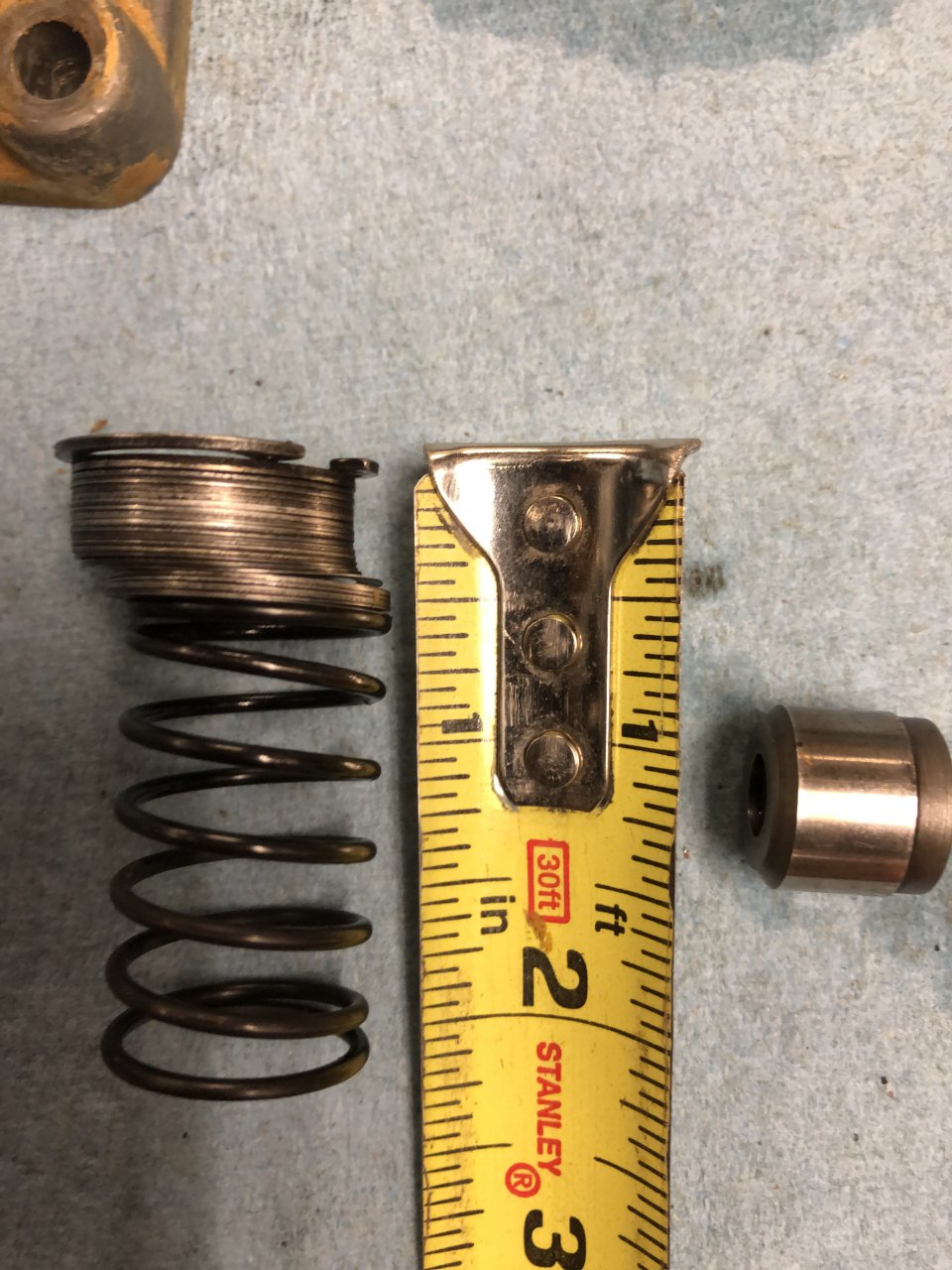

    Does anyone happen to know the cam follower gasket(s) thickness for CPL 160? “Thickness”, is probably the incorrect term but which gasket part number or combination of gaskets, to be used? I’ve got two jig timers to use, as soon as I get my heads back from the machinist. Can the gasket sets vary from one follower to the next, or can two different CPL 160’s have different gasket combinations? Are things such as cam wear, push rod wear, valve wear conducive to gasket variations? Is there a standard?

    No on the standard. Find a service manual, do the steps to gauge the thickness you need, and order the proper shims. Most will tell you to replace with the same thickness. Do not do that.

    “Do not do that”, because of wear on internals? Just curious because when Cummins built these engines new, did they use the jig timing gauges on every engine?

    I've never watched them build one, but i would say absolutely. There is no "standard thickness". Never have i had to get the same thickness as the ones I took off. Yes, that difference would be due to wear.
    As hard as they are to do, I see no good not doing it right in the first place.
    I think most used the same thickness either cause they were too lazy, or not smart enough, to do it right. It is a very important step IMO

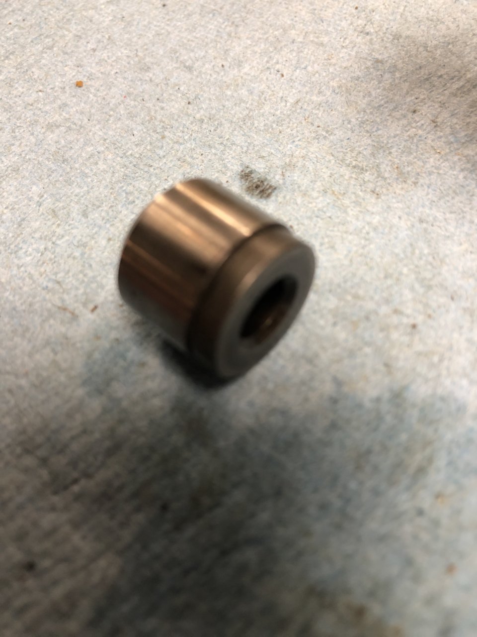

    “Cobbled up.” No way. I just recently got into the pump of the NH195 I have in my old wrecker to see why it has tremendous “crack in the stack and pulls like a 400.
    Never seen a button milled like this before either. It’s a #40. I can only guess how they shimmed the followers to set timing.
