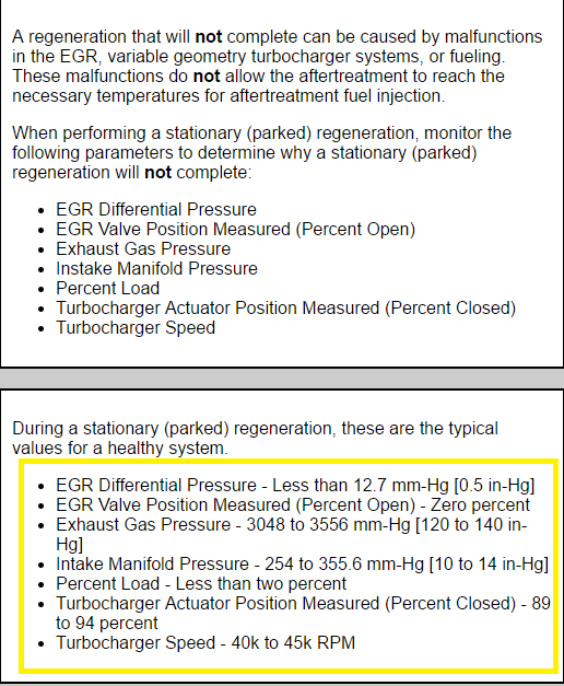

  10. Strange77
    Strange77 Light Load Member
    59
    36
    Oct 1, 2011
    Review this and make sure you record the readings as its in regen.
  11. 4vmach1
    4vmach1 Light Load Member
    184
    72
    Apr 3, 2013
    Los Angeles, CA
    Only one that's off is the turbo vgt position which is at 96% on a regen and turbo speed is 39-40k, but I'll double check tomorrow.
