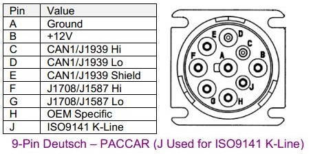

    Check for power and ground at your 9 pin. Then with the key off check for 60ohms at the 1939 pins c&d J1939_9PinDeutsch_Paccar.JPG

    More experinced input like a diagram stating exactly what pins to test in your connector?? No idea where your gonna get help like that around here.....
