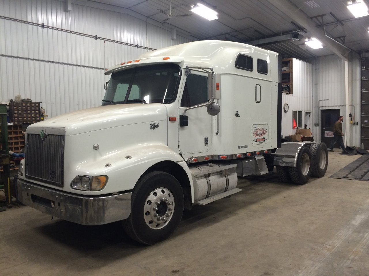

    Cm870 which I'm thinking is what he has with that truck. Labor should be around 5k. Least that's what some of the shops charge... This guy I told him about he knows his stuff.
