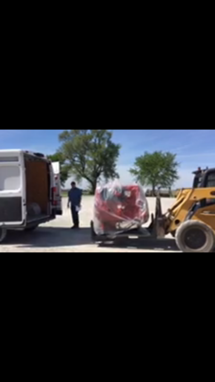

    IMG_1942.PNG It's here.

    I hope the dealer explained the warranty to you... not only are there a list of parts that must be replaced at the same time, but it also states that unless installed by a certified Cummins mechanic, the warranty is void.
  10. Tug Toy
    Tug Toy Road Train Member
    7,018
    73,579
    Jul 4, 2015
    Corn field
    Yes I have everything in writing. It was a complete engine so no other parts needed to be changed. The waranty is covered with self instal. Just had to have the ECM programmed by an authorized dealer after instal.
    Thank you for your warnings though. I was concerned about all you stated before I made the purchase. Went through the same deal with the Eaton reman transmition I installed.
