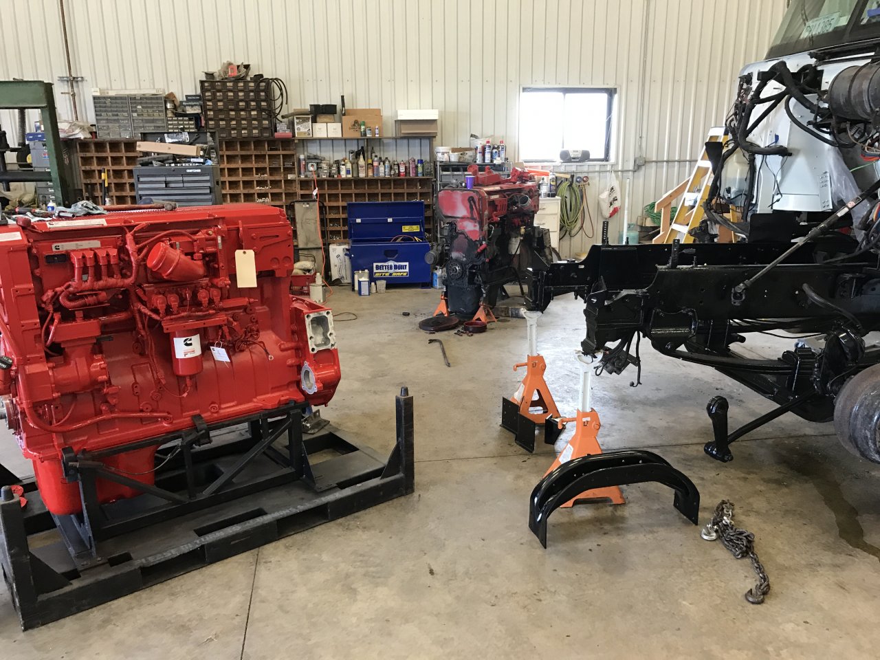

    Count on everything including the head, cams and followers being junk. Basic Inframe with Cummins parts done at a NON dealer at $20,000. Minimum. Now add cams and your going to have $30k in it.
    Cummins crate motor shipped to your door is $25,000 but you still have to install it.
    . So you’ll have $40,000 in it. It will be worth $15,000 tops once completed.
    Nothing wrong with that if you know it going in but you better not be financing if the money. I have personal experience with just such topics. 60478198-3C07-463D-B3AD-3289AF5090F7.jpeg
