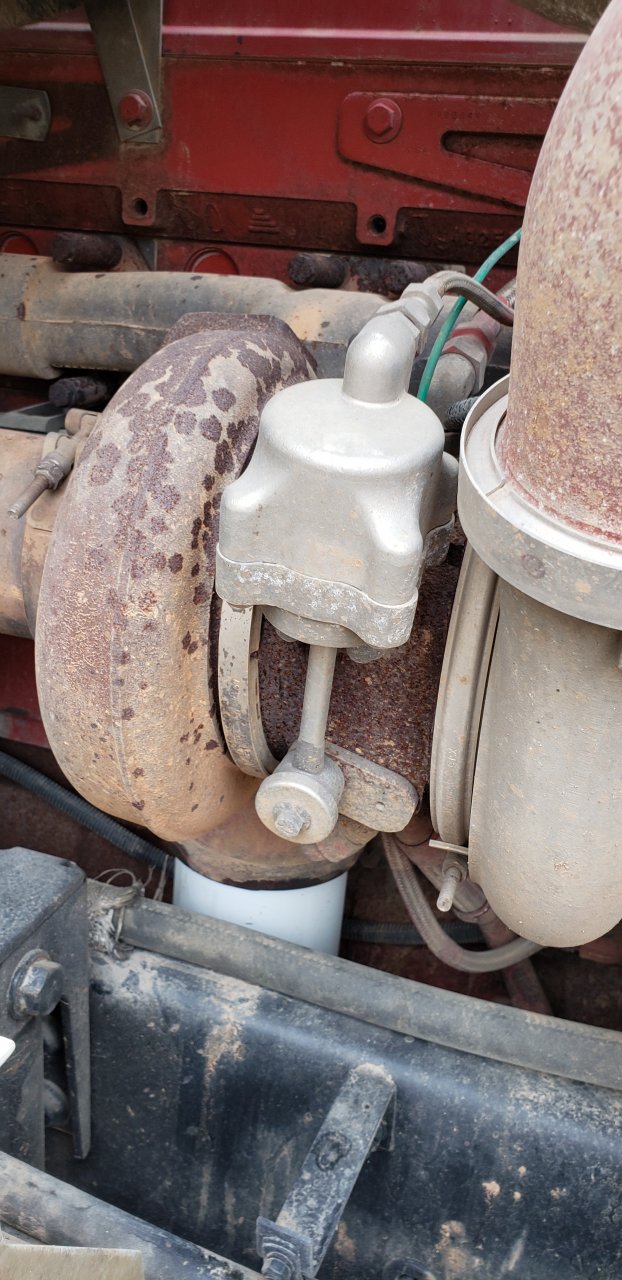

    Thank you so much, I found wrecked truck with same engine and I removed this valve and turbo for $200 but I could not tell exactly where is 1/4 line on the bottom port connected to as it was all tangled in there with million other lines, if I see it correctly on the picture your turbo has a filter? If it is it's cool I never seen one before

    South Texas
    No, that's the oil filter for the engine. The pic just makes it look like it's part of the turbo.
