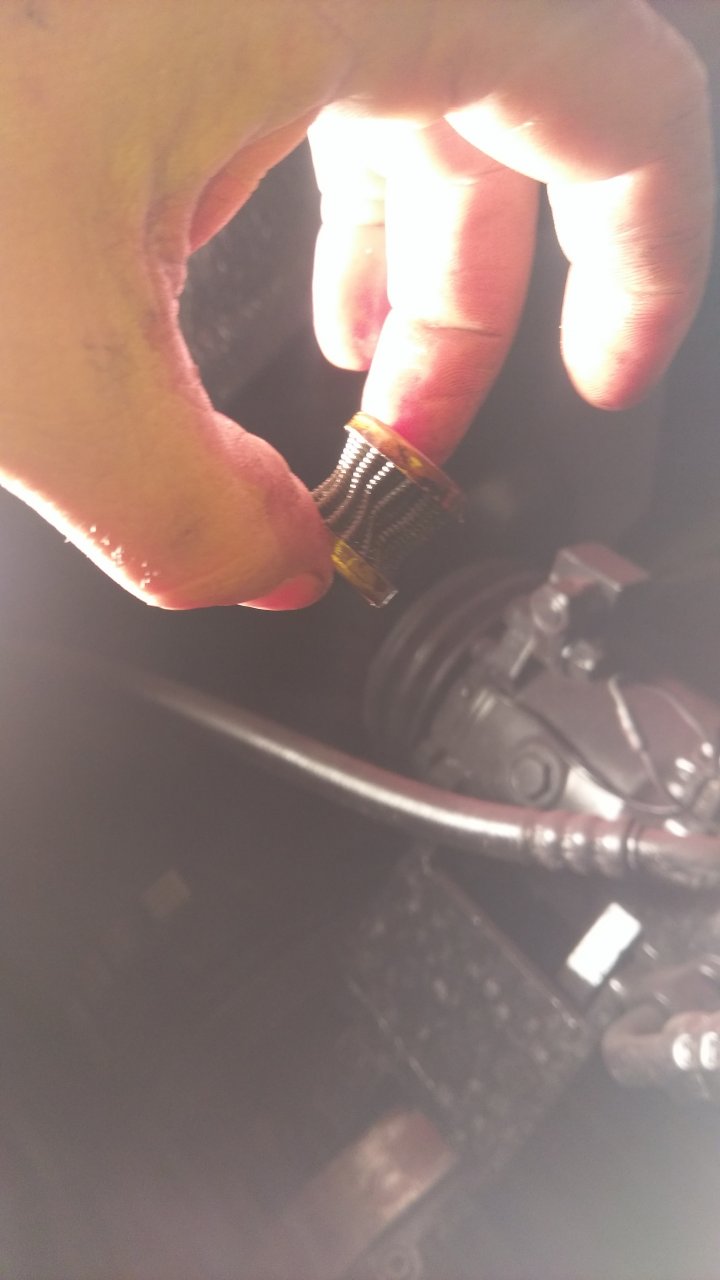

    Finally got the stupid plug out that the filter screen hides in. The old filter had completely imploded on itself. The plug was stuck in there BAD and had likely not been removed in many years. Not sure why Cummins put a screw driver slot on that thing instead of a bolt head! My mechanic welded a nut to the cap and that did the trick. IMAG3187.jpg
    Installed the new filter and there is no change in performance but now the truck is really acting up.
    The fuel filter vacuum gauge "hunts" at idle now ever so slightly but more or less stays right around where it was before.
    The BIG thing is the truck is having trouble starting, fires right up then stalls out unless you hold the throttle down and help the truck clear its lungs out. Also at 1000-1200 RPM's the truck shudders if you're trying to pull pretty hard, seems to do that intermittently. Last but not least the "Stop Engine" light came on periodically this morning and I'm getting a code 254 which is a problem with the circuit for the shut off solenoid.
    By any chance when my mechanic welded the nut onto the cap for the fuel pump screen could that have fried anything in the ECM? I made sure he disconnected the batteries before welding.

    Kinda sounds like it's sucking air, since it's hard to start now. Letting fuel drain back to the tanks. I think there's an O-ring on that screen/filter you changed. That would be the first place I'd look.
