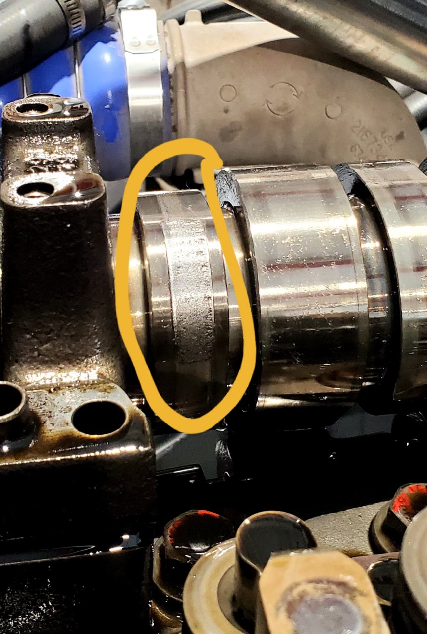

    Just found this on my 2014 D13 935k mikes..what would happen if I just closed it up amd ran with it like this?
  9. lester
    lester Midwest's #1 Feed Hauler
    2,935
    7,940
    Jan 2, 2012
    NW, Iowa
    Nothing good I would say. It's going to keep wearing as well as the roller. Metal in your oil.
  10. Kenllah
    Kenllah Light Load Member
    226
    113
    Nov 17, 2017
    It will run until it won't. No one can really say how long it will go honestly. you will probably start to notice some performance issues. If you are gonna run it I would keep up with the oil filters and keep an eye on it. There will be metal coming off of it and it has to go somewhere. It will start to wear away at your cam follower as well if it hasn't already.
    If it was mine, I would probably change it asap. Who knows how long mine looked like that before I found it due to an unrelated oil leak.
    I understand that not everyone is in the same place financially but it isn't going to get any cheaper to fix it as time goes on.
