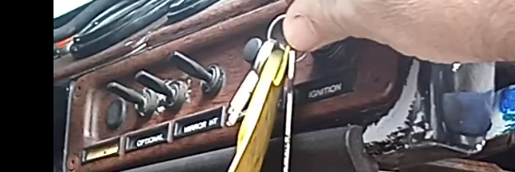

    I am away from vehicle now - but am looking for an air pressure sensor and can't find any - however in a wiring diagram - have found an idle increase/decrease switch - that could operate - after system is up to pressure - or the brake switch has allowed it to operate - so am going to search the dash for this switch - I will paste it here if I can.
    That Brake switch looks like a pressure switch - and when pressure allows - it allows the idle inc/dec to operate - so will find this switch next - it could be operating according to the preset idle speed - and we are blindly unaware of it's existence :)
    PTO was engaged - yes - good point !!!! - but from memory - rpm raises without PTO engaged as well
    2 areas to search now :)
