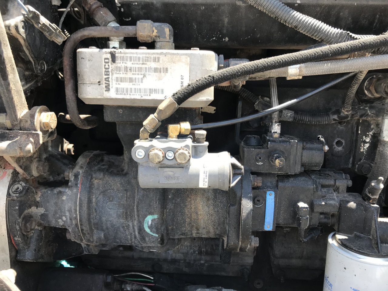

    Not all N14s have the Holeset compressor. My ‘99 has a Wabco compressor and dryer. Since his is a ‘99 also, I’m thinking his may be supposed to have the same style?
    Either way, the correct dryer for the compressor is a must.

    I’ve put two rebuilt compressors on my truck in the 3 years I’ve owned it. Not passing oil, they just get slow to build air.
    I’ve never had a Holeset compressor so I don’t know much about them as far as problems.
