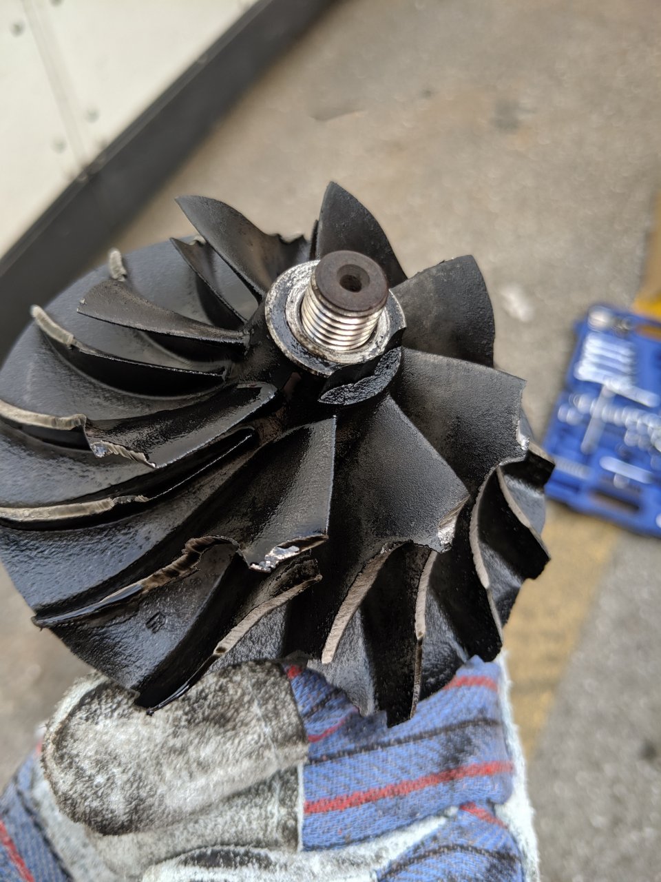

    Replacing my n14 turbo at a truck stop parking lot today MVIMG_20190610_104929.jpg
    Should I worry about the oil that got everywhere? It's in the exhaust pipe and it's also leaking from here

    You will want to clean the air to air out, with steam preferably.
    Also check your air cleaners and all piping, for metal.
    DUNE-T Thanks this.

    Be carful that the air to air cooler is not full of oil.
    If it has oil in it when you start it the engine it will suck the oil in and run on it with the RPM going to the moon and no way to shut it down except cutting the air intake off.
    The last one I saw do this ended in a severe oily mess with a window in the block where a connecting rod came out.
