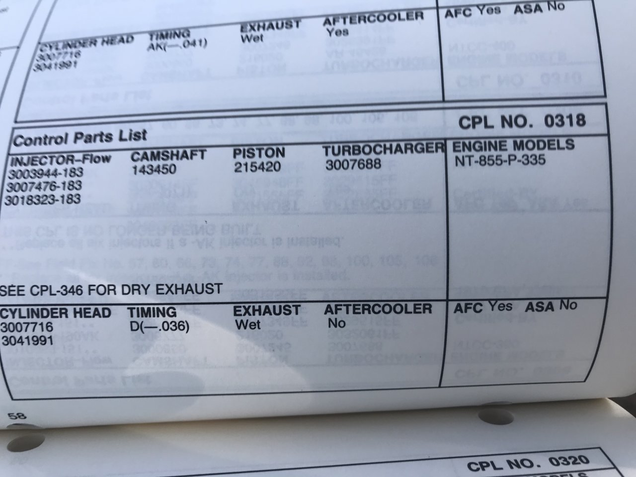

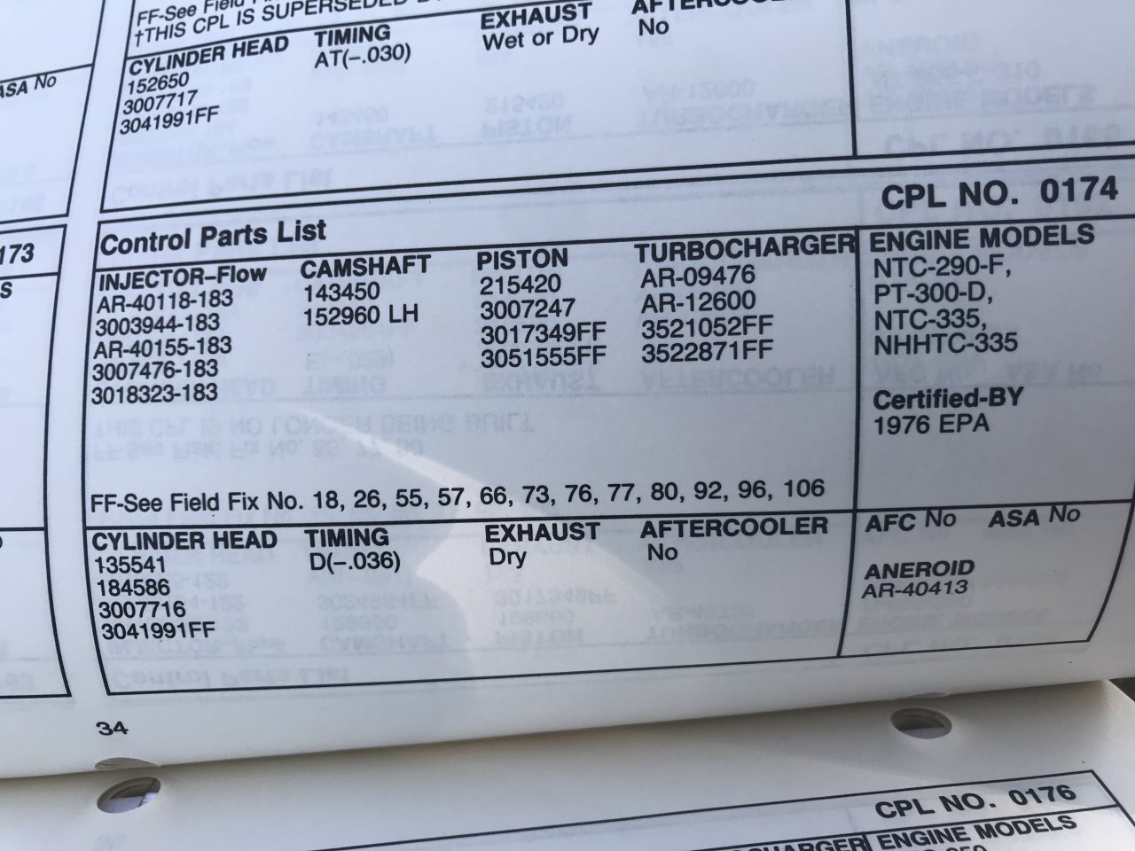

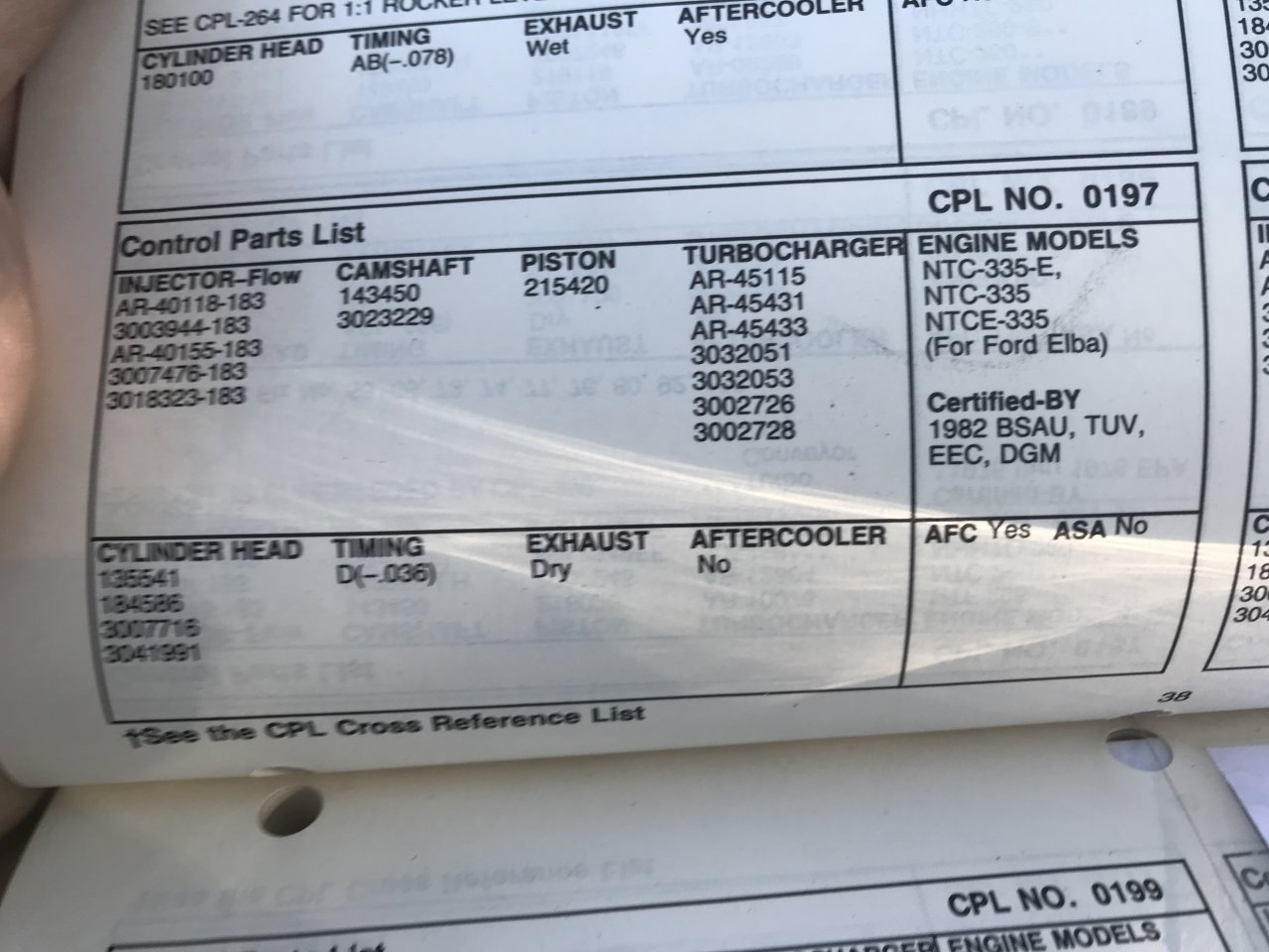

  4. mile marker 27
    mile marker 27 Road Train Member
    1,351
    1,707
    Dec 4, 2019
    Yes, a 335 is definitely a consideration. There’s CPL’s, 0174, 0197 and 0318. Those are all 335’s with matching cam and non aftercooled.

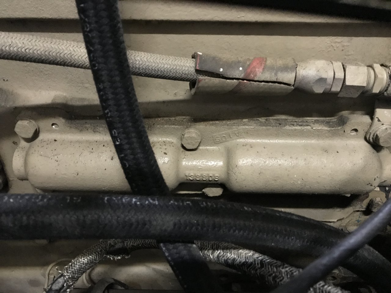

  7. mile marker 27
    1,351
    1,707
    Dec 4, 2019
    So, it seems I need to pull the cam followers off to see what gasket is used?

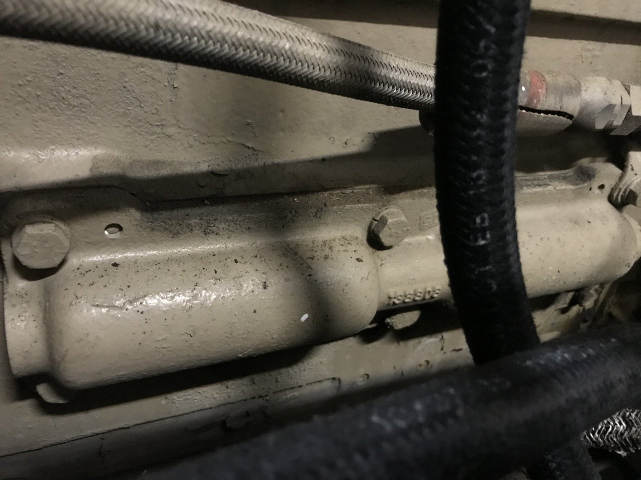

  10. mile marker 27
    1,351
    1,707
    Dec 4, 2019
    DC6B1472-2ECE-453C-8961-3A91ADBA01E9.jpeg D943F511-17F6-49D0-8C07-219372B413AD.jpeg
    Here’s a pic of the cam follower.

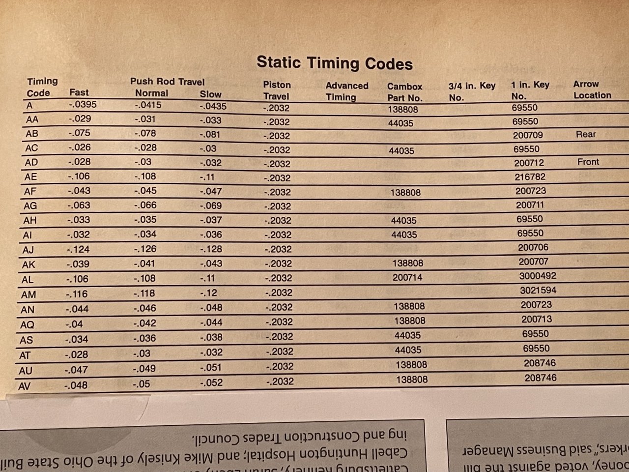

  11. Inderjit
    Inderjit Heavy Load Member
    745
    725
    Sep 17, 2017
    CPL #s 0021 and 0160 were good small cam NTC 350 engines. Timed at -.041"
