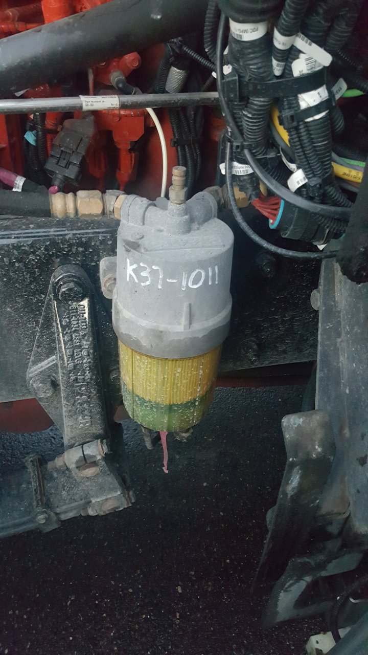

    The first pic is a davco.
    The 2nd pic with the k37-1011 is paccar's lousy version of a fuel water separator.
    The benefit of a davco is you only change the filter when the level gets to the black line at the top. You can also see if the fuel level is constant to the fuel pump. As the davco collects impurities in the fuel, the level will rise. The upside down peterbilt version is always full of fuel, you have no idea what the fuel restriction is or isn't. You just change it at every oil change, or every other, or a set number of miles, etc. Plenty of opinions on when to change. Mine was problematic with the oem filter, it would run like it's starving for fuel after maybe 12-15,000 miles in summer and in winter it wasn't uncommon to have the same symptoms after only 5,000 miles. The filters cost about the same. Also - I do not have a fuel restriction gauge. I'd like to, dash space doesn't currently allow and it isn't too high a priority anymore.

    Davco is the probably the largest/most installed and oldest fuel/water separator company. Also the most reliable.
    NOTE: All suction side fuel filters experience bubbles. It is normal to see champagne size bubbles in the fuel processor at the Fuel Pro/Diesel Pro outlet or at the lift pump.
    Weekly water drains 1. Turn off the engine and remove the vent cap. 2. Place a suitable container under the Fuel Pro and open the drain valve. 3. Collected water will flow into the container. When fuel begins to flow out the drain, close the drain valve. Drain the least amount of fuel as possible. 4. Install the vent cap and tighten it by hand until it clicks. 5. Start the engine and raise the RPM for one minute to purge the air from the system
