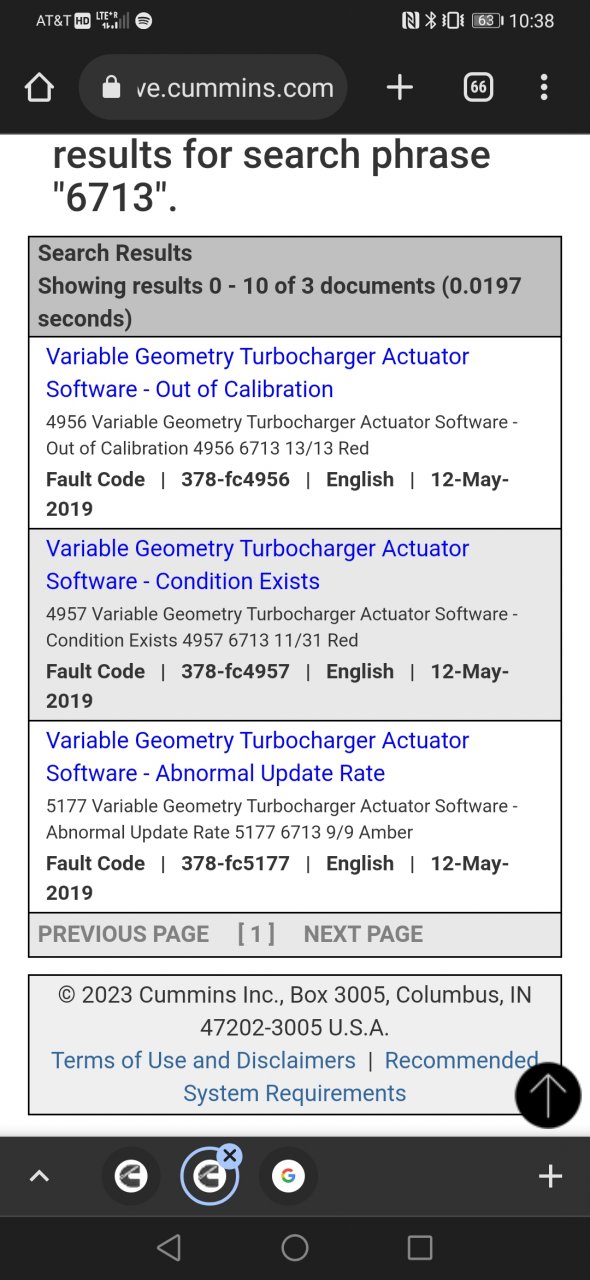

  10. Josiah Harder
    Josiah Harder Light Load Member
    120
    73
    Sep 23, 2022
    I looked it up on Cummins quick serve online and that 6713 isnt the specific fault code but rather a circuit in which 3 different faults could take place in. 1 of those is the 5177 fault that I had and the other 2 are software and calibration issues. You'll know if it's the same as mine if your truck gives an amber check engine warning because the other 2 faults will give you a red shut off engine warning it says
