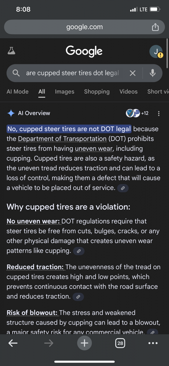

    IMG_2238.png According to doctor google they aren’t even legal. So that’s twice they lied to me. “They will even out” and “they’re cupped but still legal because they have enough thread and not showing any metal”

    Never heard that cupping tires aren’t legal on the steer. I suspect google may be wrong unless you find the reg that states it.

    They are still legal, The Goog is wrong (as best I can tell from your pics anyway)
    But, they won't be for long. Once that flat spot gets below 4/32", it's done. And, that's gonna be one vibrating MF'er
