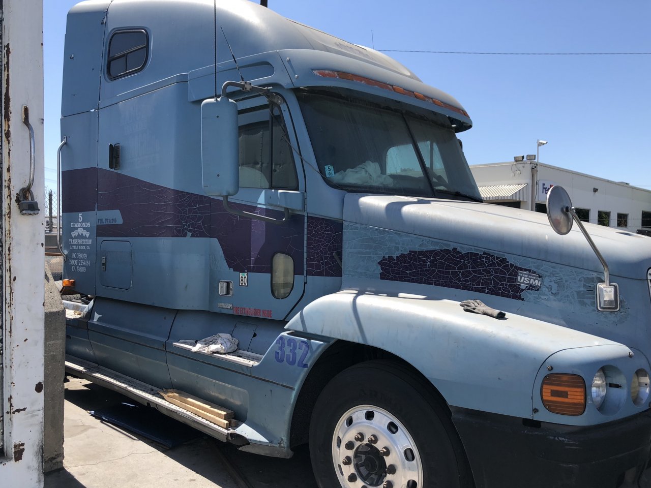

    I’m in Rancho Cucamonga CA and I want to get my century repainted the same Werner blue color just without this ugly purple stripe LOL. Anyone know what it may run me for a paint job?

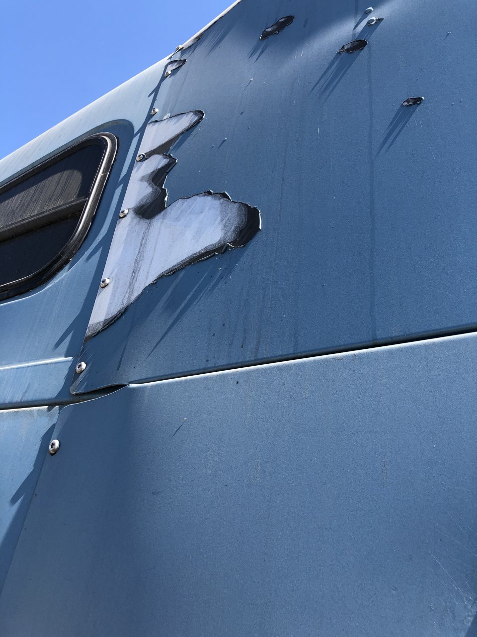

    I want to have it repainted a solid blue like the one in the images below

    You're close to Fontuckey, the trucking capital of the World, drive up and down Valley Blvd, Slover Ave or Cherry Ave, there's tons of different shops there that can give you an estimate.
    A complete paint job price is dependent on how nice a paint job you want and how much you're willing to spend.
    Do you want it painted like it just came off the assembly line, than there will be alot of parts that are going to have to come off and masked off so it doesn't look like it was painted in TJ or a One Day Paint shop.
    Without seeing the truck in person, for a top of the line paint job with a quality paint like DuPont Imron or equivalent, R&R body panels, skirts, weatherstripping, minor bodywork, cost of paint and materials and labor you're looking at upwards of $9k from a friend the runs the Volvo dealership body shop in Fontana, CA.
    When it comes down to body and paint you get what you pay for.
    How nice you want the paint to look is how much you're willing to spend in preparation and materials.

    Yea I will mostly likely end up doing that but I was just wondering the price range. My truck is not a show truck by far and I will be bringing it back to NYC for local work so I don't need a very expensive paint job just something better than it look now.
