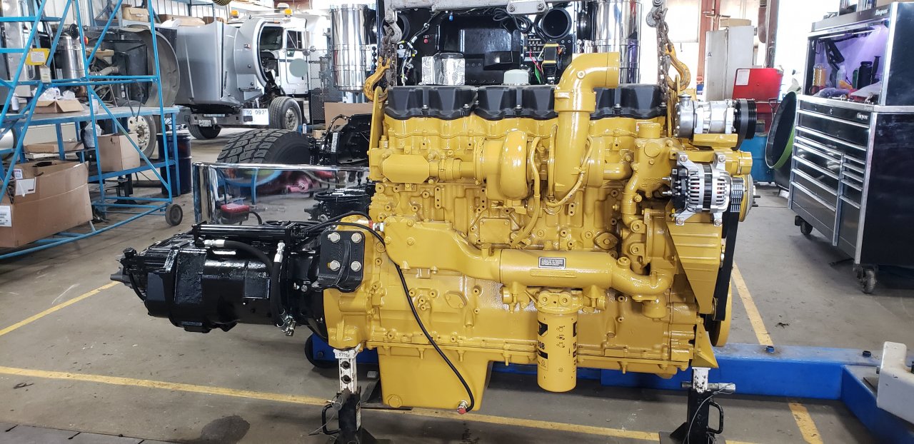

    Brand new 6NZ reman from CAT. If you look at the block there is alot of extra ports and bolt holes. Its actually a SDP block. They must only make the one block now to use for everything.
    Cummins does the same thing, the blocks now are for a 870-2350, possibly also x15. They come with a fitting kit that blocks off the unused coolant ports the 870 needed.

  7. spsauerland
    spsauerland Road Train Member
    4,296
    10,889
    May 31, 2010
    West Harrison, In
    Love the look of everything in that picture except for the coolant heat exchanger on the transmission!

  8. pushbroom
    pushbroom Road Train Member
    1,779
    7,317
    Sep 1, 2012
    Gotta run em up here. When its -40 its hard to tell if you are in neutral. This truck is heading up north quite a bit.
    If you check the oil every service you can usually change the cooler before it shreds the scyncro ;)

  10. spsauerland
    4,296
    10,889
    May 31, 2010
    West Harrison, In
    At least it ain't to bad to change out on a Pete with the larger floor access hole vs a KW. Now if they would only keep an access hole open and not covered with flooring on an Ultrashift equipped truck. Had to repin the harness pigtail for rail position sensor on side of road last week and it was all I could to reach it and uncut zipties.
