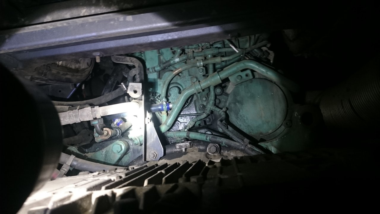

    guys , I have oil leakage from back side , 2015 volvo 670, d13 . 585k , any idea can help

    Looked at a lot of leaks. That isn't running down and dripping on the ground? Appears to be small, seeping leak. If so i wouldn't worry about it. Just check on it pretty much daily. You also could (if you take the trk home) spray some engine cleaner on it, let it soak a bit, and spray it off, with even a garden hose. Then see how fast it seeps . If you go to a truck wash, don't let them high pressure your engine. Thats asking for trouble, around electrical components. Of course if it dripping head to a knowledgeable shop. Years back some engines dripped quite a bit. We used to call it "sign its name" on the ground where you parked. Oil consumption get worse lately?

    Hello and thanks for your help , it's very small leak Only smoke comes from this area when I do regen, but there is no dripping on the ground, also I check the oil level every day and not loosing any oil, I used 15w40 Mobil every 15k ,

    I would clean it as much as possible and put some dye in the oil, then check again with a uv light to be sure.

    this is a very simpe leak, not that simple to fix but fixable. the top timing cover on the new engines now they are made out of POS plastic and what happens is the gaskets go out and they start pission oil. to fix it you need to remove dog house a few hoses and some wiring inthe back remove the valve cover remove the top timing cover and replace with new one around $200 parts at volvo problem is to install it you need special tools to push the cover down so it seals. more labor than anything but still shouldn't be more than 500-600. top gear cover is what you need or top timing gear cover. for some reason 15 are the years they first started with this and they always leak 16 not so bad and on but 15 horrible for this leak.

    Interesting...I would "venture to say" that the plastic cover and iron heat up and cool down at different intervals/temperature thus blowing out the gasket.

    This is part of it but those seals are so small that over time heating up and cooling down they become rock hard and do not seal anything anymore but it is cost effective so of course that’s what they put on

    I have the same oil leak with my truck, also 2015 d13 603k miles. Change the o-ring on the flywheel housing (top right side)
    volvo replaced the top cover gaskets last week, and still oil leak..
    please help!
