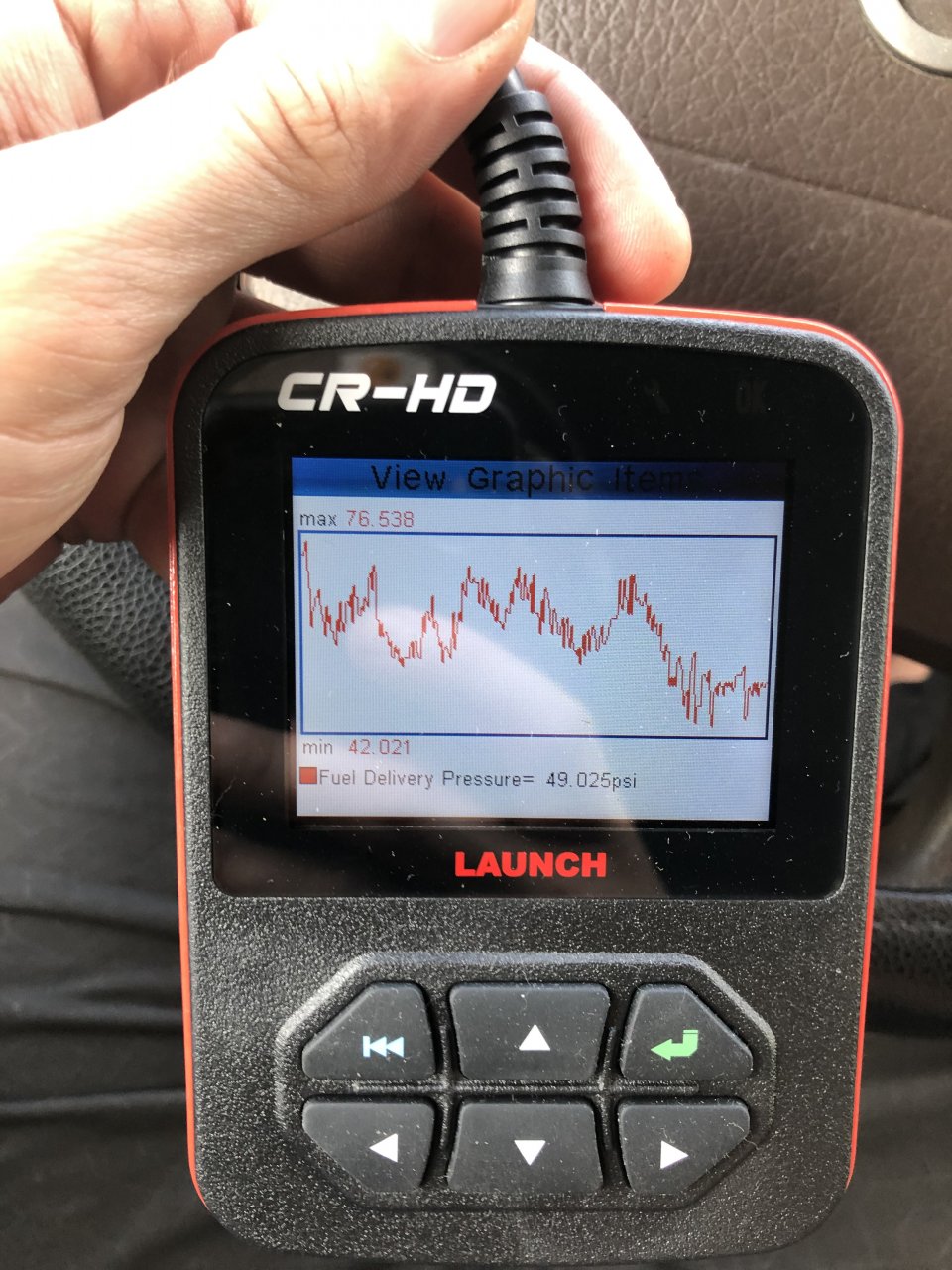

    1.There’s this inexpensive tester that might help you out. Launch CR-HD. It will show you fuel pressure LIVE. On a test drive you will see everything what’s going with a fuel pressure.
    2. Did you strip the thread in the exhaust pipe for the two little bolts that secure 7th injector?? If so then you just need steel thread inserts installed, saves you whole lot of money.
    3. If this truck is deleted then there should be no diesel coming out out of 7th injector. AHI module might have leaking fuel shut off valve and that’s where you loosing pressure under load. You can try to block off the fuel line between fuel filter housing and AHI module and test drive it like that monitoring fuel pressure.
    GET THE TESTER!!!

  9. Issak
    Issak Bobtail Member
    4
    Feb 15, 2020
    This is the code
