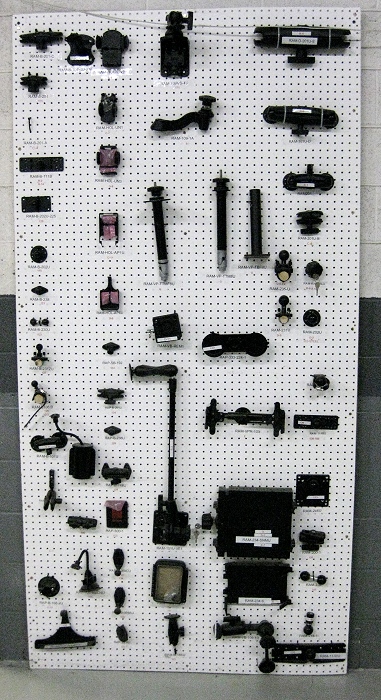

    Dude. Meet the "wall O' Ram"
    This is about 20% of the mounting stuff I have.
    I can mount anything with the right Ram parts, lol.

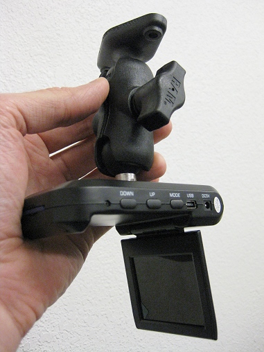

    Done. ($19.99 in Ram parts.) Double-ball and socket mount, lifetime warranty. Use your screws or bolts to screw it to anything flat, curved, or angled above your head to hang a camera (or anything else) rather than windshield suction-cupped.

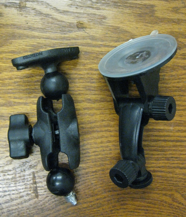

    This looks exactly like I was seeking. From a hang-down perspective is it comparable to the length that this would be if it was using the suction cup?
    Hows does the physical camera attache to the Ram Part device and how does it come apart?
    Can I see the ram mount by itself? - I wonder what might be left hanging when I remove the DVR.

    See this pic.
    The Ram version is virtually identical in length that is will be down from the ceiling (about 4.5")
    The only part left when you pull the camera and socket arm off the ball is the upper ball. Both the suction mount and the Ram mount thread onto the top of the camera just like any bolt. You can see the lower ball threads in this pic now that I separated the mounts from the camera.
    As far as the wiring, you can do what you want, but don't send 12 volts directly to the camera. The factory plug drops it to 5 volts.
