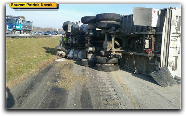

    He was driving a 4-axle straight truck. Rear most axle, a drive axle, broke free:
    I suspect the right rear torque/trailing arm failed (or the bolt was loose and fell out on that last expansion joint). When under power, that trailing arm is what keeps the axle from moving forward. With it inoperable, the right side of the axle would move forward, steering the back of the truck to the left (pointing the front of the truck to the right). A hard yank on the steering wheel to the left in hopes of keeping the truck straight caused the truck to start sliding sideways. The RRO then blew, causing the truck to dip, at which point the wheel dug into the pavement sheering the axle all the way off and causing the truck to bounce and then tip over

    DY there is another part that will have played a part in this.The driveshaft.If it broke at its front joint first.........speared itself in the ground........

    In addition if you look at the photographs the steer tires are still intact-with no indications of a blowout or any other type of failure. It was definitely a Mack dump truck(the bulldog is visible in the video) though,the question is which model?
