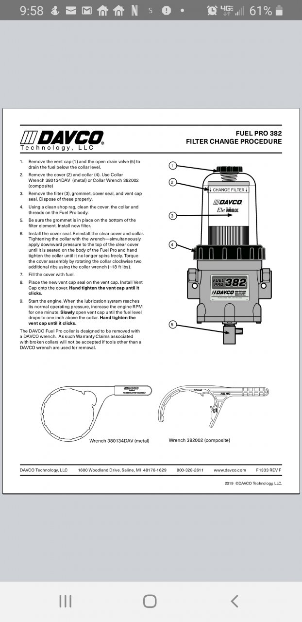

Davco 382 / fuel filter not filing up
Discussion in 'Ask An Owner Operator' started by henboy1, Jun 20, 2020.
  1. jamespmack
    20,033
    216,319
    Read davco instructions, then come back with your "opinion".

  6. jamespmack
    20,033
    216,319
    Knowing what your talking about is half the battle.
