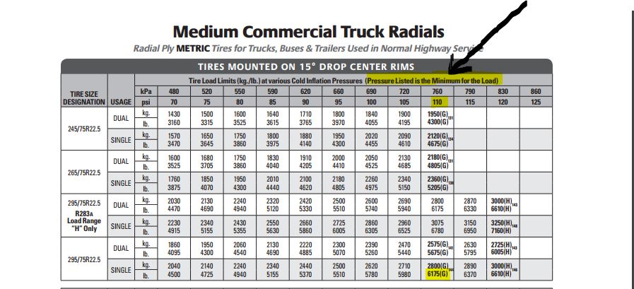

    Says 110 on the tire and Bridgestone Web site.
    110 is max.
    I'm at a TS that has air, I'll go 110 in the morning.

    110 is the minimum psi for the maximum load...
    12350 lbs is the maximum weight rating, some will say I never go over 12k lbs, but think about everytime you brake all the weight that is transferred to your steers, the more the sidewall flexes the more heat is generated causing irregular wear and premature failures... These low rolling resistance tires wear more consistently at higher pressures.

    Stamped on the side of the tire 110 max.
    You do whatever you F want with your tires.
    I'll do what I want with mine.

    I will, 250k miles on my last set and 7/32 left when I swapped them out.....
    and it doesn't say 110 max. Commercial truck tires do not list max psi. its max load at specific psi, and I as showed you the load range chart from Bridgestone its min psi.

    so it didn't say 110 max???
