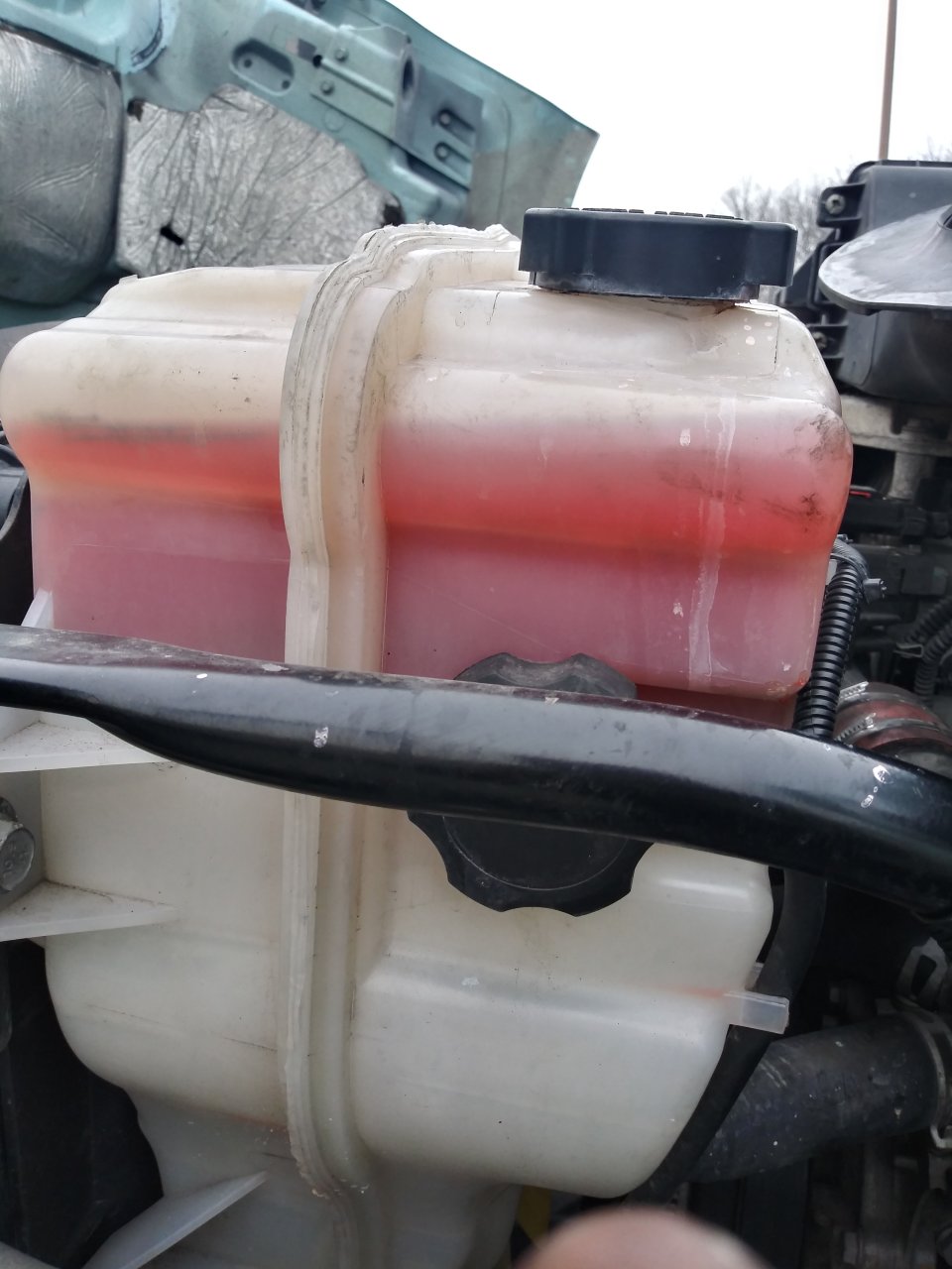

    Ok every one. I got to the butter fly in the egg and it moved freely. I will need new batteries for the flaslight to see if there is liquid in the p egr tube. Or if it's just wets.
    Attached is a picture of the coolant. Let me know if you think its doscolored.
    It is low. But only long enough to get this picture. And let it cool down. 20220112_144311_HDR.jpg
