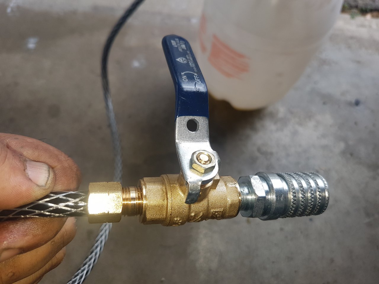

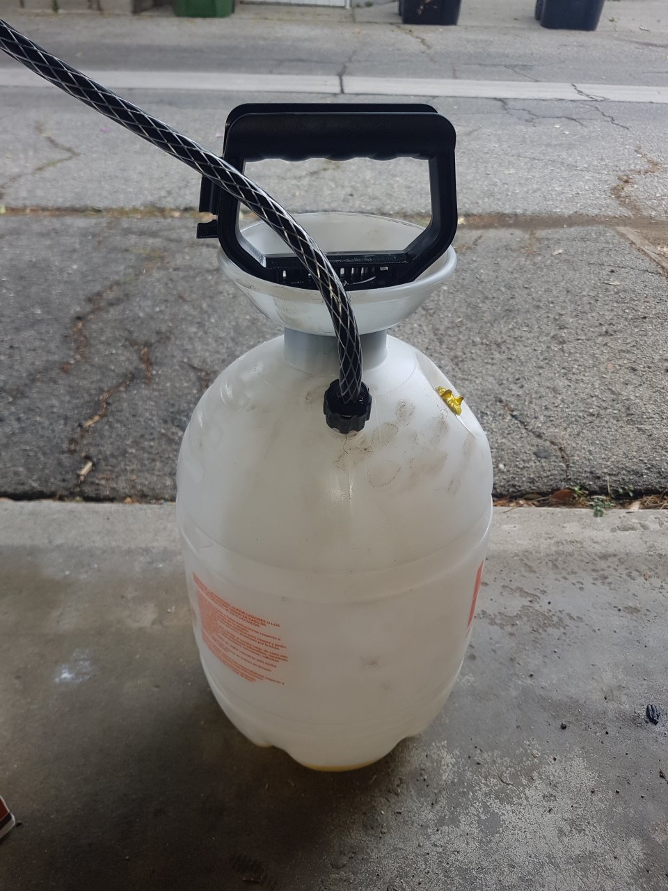

    Poor men DD15 fuel primer :)

    Nice Brother! The compucheck fitting costs more than the rest of the pump parts combined!

    Exactly. the bag sprayer was $15 and another $15 for ball valve, union , barb fitting. Parker PD-243 was $55 .

    you plug it to fuel filter housing. Pump the sprayer and the fuel go into system...

    Man, I changed my fuel filters this morning for the first time, and I struggled to prime the fuel system. I think where I messed up was not filling up the fuel filter housing enough so that it would overflow when inserting the filters. This method will waste a little bit of fuel, but it won’t let air go in.
