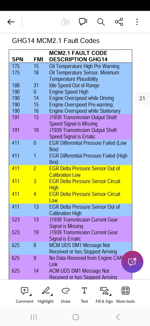

    I have a 15 freightliner with a DD13 in it. Check engine light has came on with the code spn 411 fmi 1. I have also notice it hasn’t been using much def. I put close to 4 gallons in it this morning and i put 1.5 gallons in it week before last. I’ll also add that before the check engine light came on, the regen light came on first.

    Here's the code meaning

    Thank you hopefully it’s the delta pressure sensor
