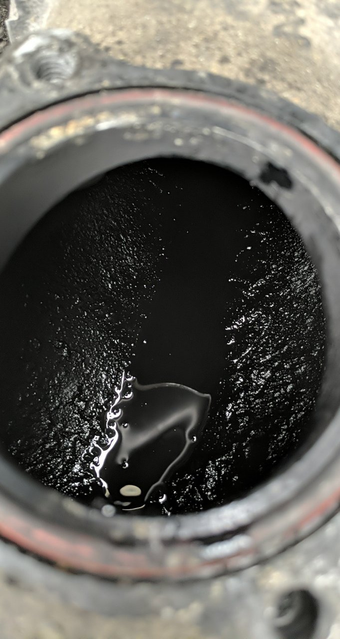

Took off hot cross over pipe and it's dry but intake side and turbo side CAC pipes have oil in them and a good amount. I'm totally lost on what's the main culprit ? Blocked EGR valve from Clogged DPF running days that caused turbo failure ( but turbo spools and seems to be working) but on the other side , would it cause the excessive Blow-by. Head gasket ? Liner ?

cel was out in the morning and that's when I took apart piping and noticed oil in them.

Turbo cartridge seal leaking oil into intake. CAC saturated with oil internal causing 2631/1 code. Turbo will still spool cause implellers still intact. R/R turbo and CAC (or remove and have cleaned properly)

Sold the truck to local mechanic, he took it apart. Cyl 3 cracked liner and blown Turbo. Sold it for 7k.
I was running for couple of weeks with what seemed to be clogged DPF filters then did a delete and within 200 miles after issue appeared. Most likely truck ran way too hott stressing Turbo n CYL head. -
