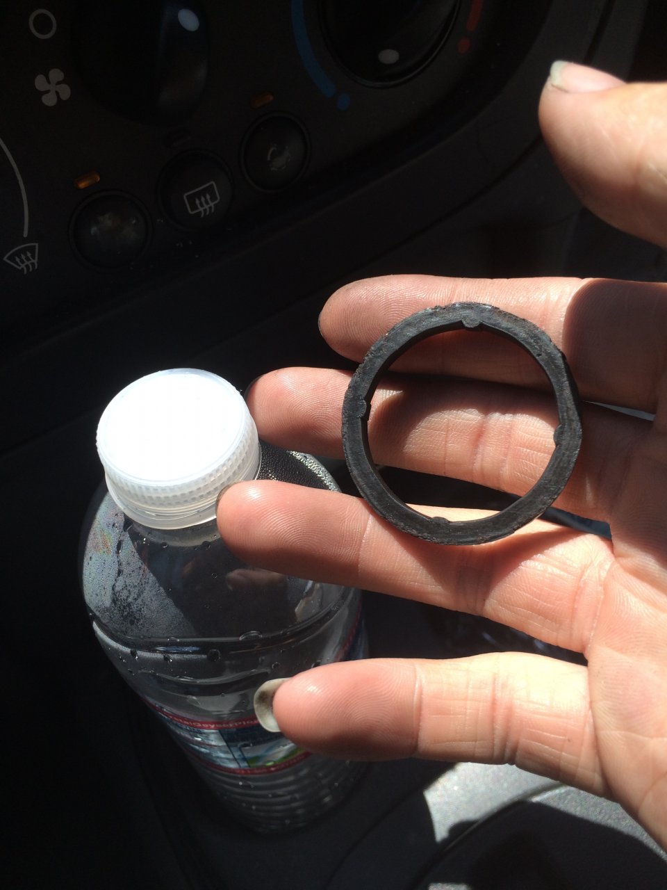

    usually oil coolers two gasket seals get old and under pressure oil sneaks to cooling system. basically engine needs 3 gaskets( $ 110-120), a gallon of gas to clean coolant reservoir, one coolant filter, 10 gallons oil and oil filter. If cooler element must be changed add another $250.
    $7000 for that repair is highway robbery !

    I have the same problem. Changed the 2 o-ring in the oil cooler module. The problem solved! My suggestion is better you change the oi cooler module too, that thing get old and may leaking someday. And you can order the coolant reservoir on ebay for better price, same quality.
