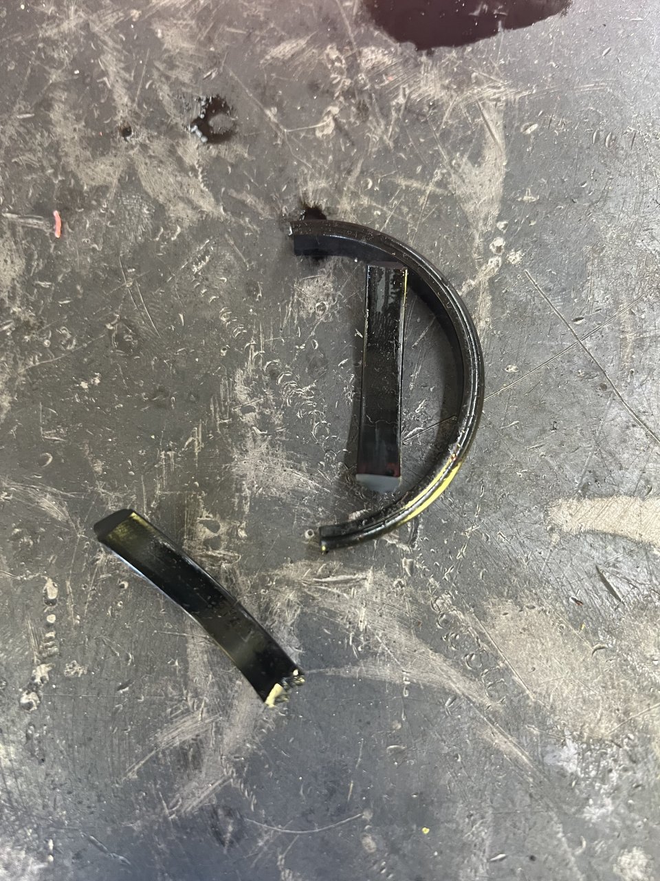

    This is exactly why I don’t trust people and mechanics.
    supposedly these orings and pump as well as the manifold had been changed at 487k miles on the truck. It’s now sitting at 597k miles and the dates on the parts read 2012.
    Verify it’s changed and see for yourself before they put the parts on.
    orings shouldn’t break like plastic pieces. If the chip on the pump gear was there but the dates said 2018 I would have been ok and said pump failed. But no.
    Good thing I was able to get home to get it done after a 5 second low oil pressure warning. In Kentucky.
    B1655E31-C555-4022-B7A7-B6381BA12FE4.jpeg 68D782DD-D772-4960-85CD-0E841F2D734D.jpeg

    5-7 hours, if done right and it’s the pickup tubes on the pump. This has to be done at 500k maximum. I would at 250k after seeing this. That o-ring exploded in my hands. It’s hard as a rock.

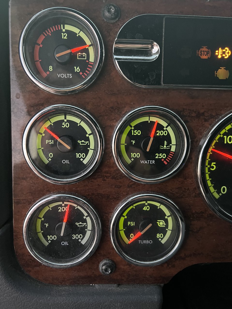

    What a difference in oil pressures.
    Fully warmed up idle pressure is at 25 Before was at 16
    high idle I’m at 33 previous at 23.
