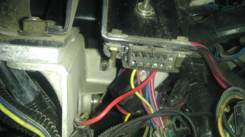

    I attached a picture of it, it appears to be 6 pin. Is this correct? I ordered the GM OBD 1 to 2 adapter. Not sure if I need it, but just to be safe. This is right about the throttle pedal in my truck. Again, this is a Series 60 and a 9 speed. What is the style of connector for this, as seen pictured above?

  9. Heavyd
    Heavyd Road Train Member
    7,752
    6,185
    Feb 4, 2009
    "6 pin" is slang term for the round adaptor. The one in your picture is an old school OBD connector, just a coincidence it has 6 pins aswell. The adaptor you ordered should work just fine.

    Twisted pair is J1587/1708, other two terminals are ground and +
    So you can get 6 pin connector on JY and easily fit it in your truck. You can use probe cabel too
