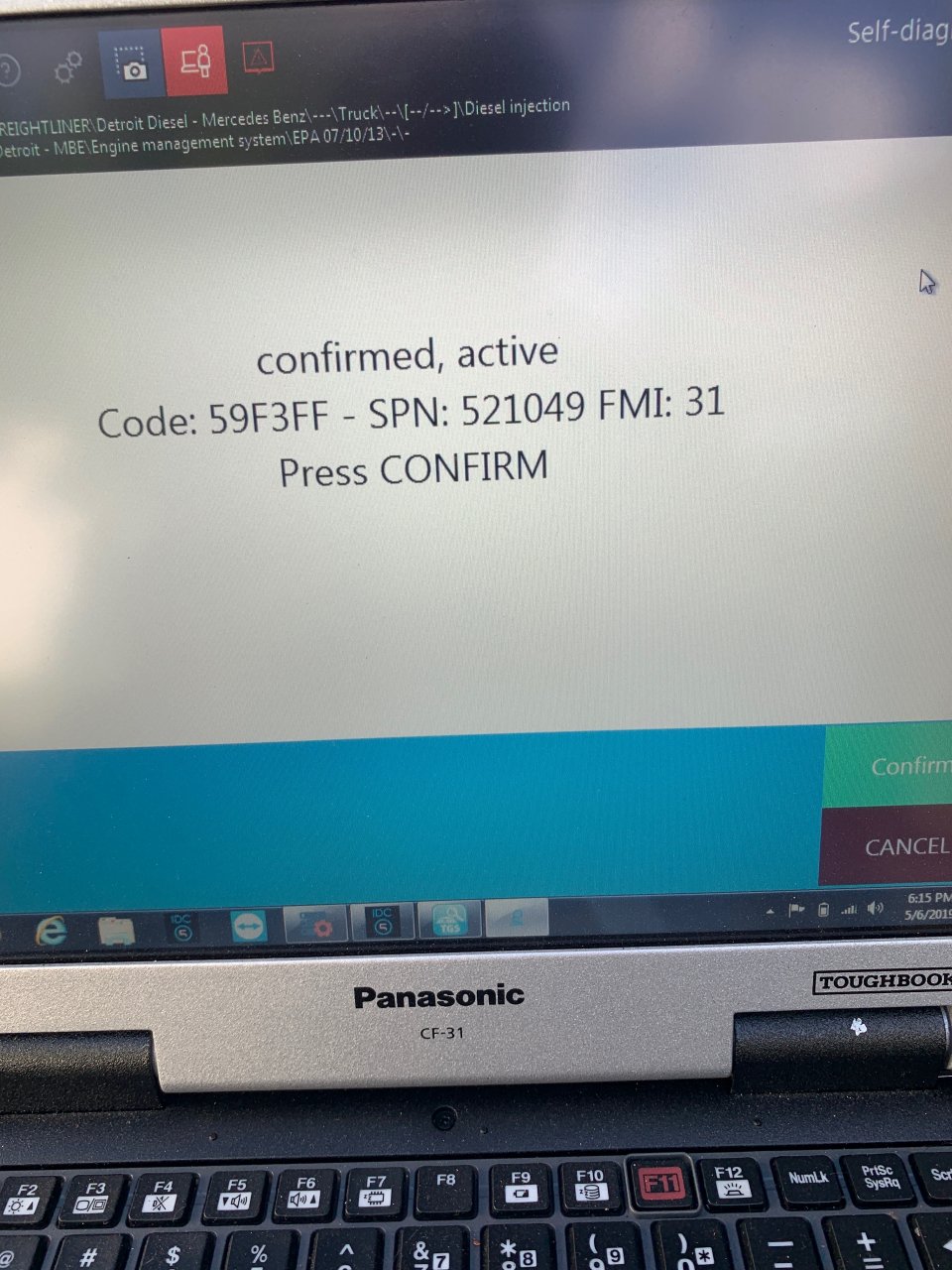

    So what codes can you pull off the dash? Should the a SPN #### FMI (or FAIL) ## post those and maybe we can help. From what you’ve posted all I can tell you is you have and after-treatment issue that’s been ignored.
    Also, with those light flashing that way, don’t fill diesel or DEF, you’ve got a good chance of initiating theGovernment Code that locks you to 5 MPH...

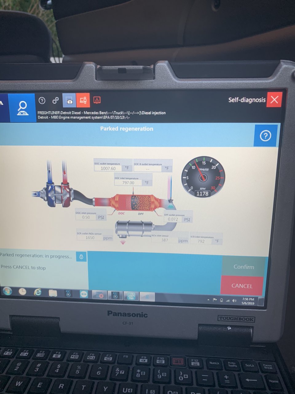

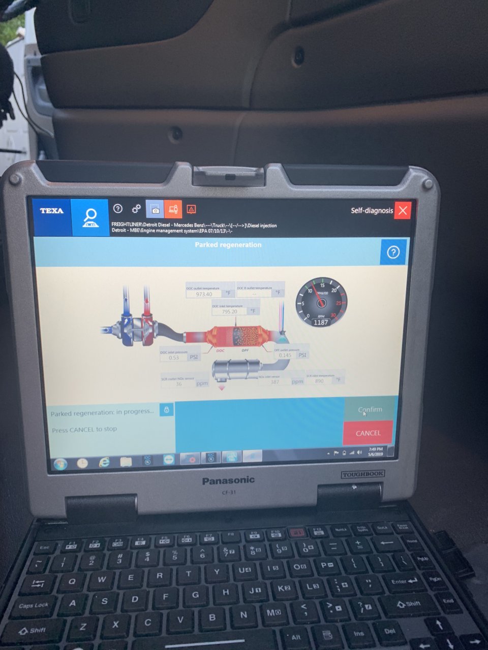

  7. Volvo 2015
    Volvo 2015 Bobtail Member
    32
    3
    Jun 10, 2018
  8. Volvo 2015

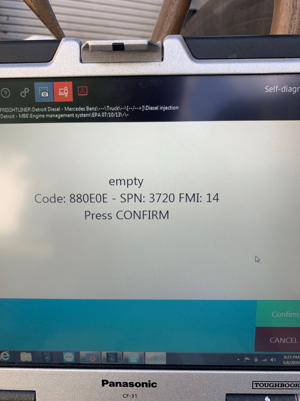

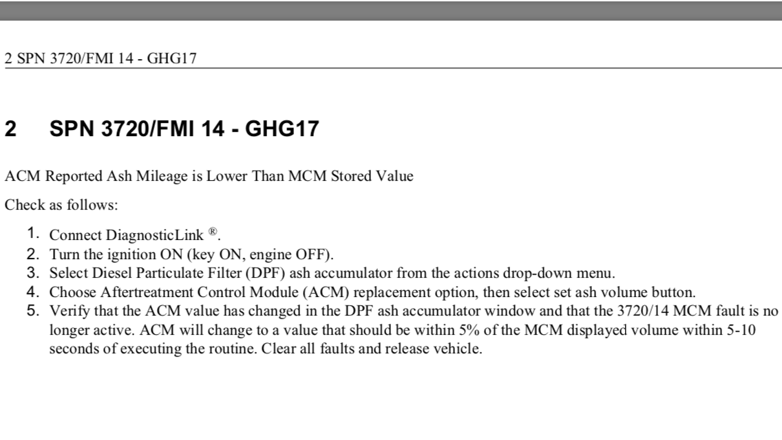

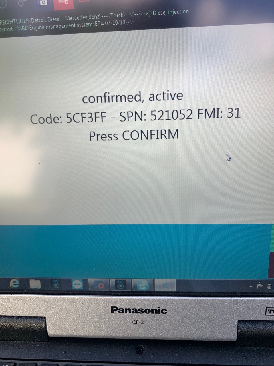

    The first two codes I didn’t look up because they look like Government codes to track how long the code has been ignored. According to Detroit’s troubleshooting, your ACM (Aftertreatment Control Module) ash Volume doesn’t match the Value the MCM (Motor Control Module)
    The trouble shooting makes it sound like you just need to reset the value with your diagnostic computer
